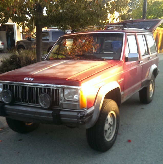

I'm gonna begin with introducing my Heep. This is how Otis looked when I first got'em.
Why Otis? Well, once upon a time I was standing in an elevator and I looked down at the door entrance and it said Otis. Now this was all long before I had my jeep. I thought Otis would be a fitting name because my jeep takes me up and down mountains etc. A little cheesy but hey, I couldn't think of anything else.
Ok so it's a 1991 Jeep Cherokee Laredo I6 5 speed. Yes I know how to drive stick.
I bought Otis November 2, 2014.

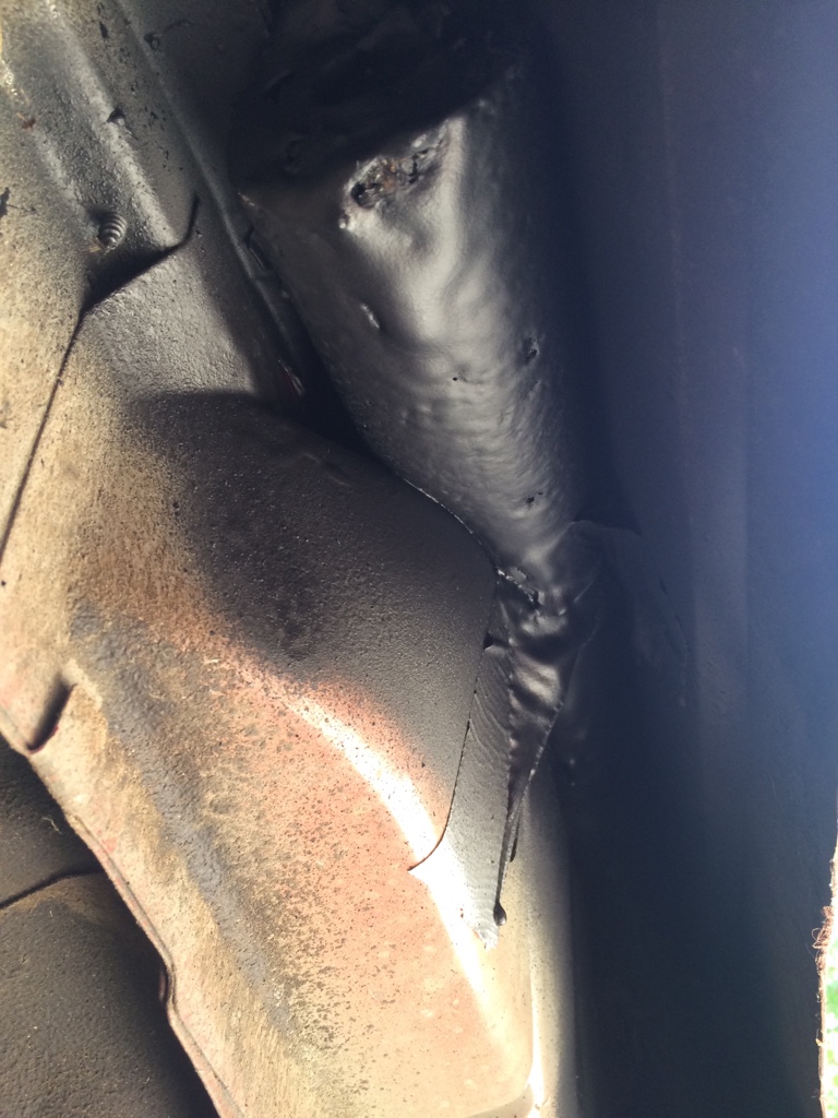

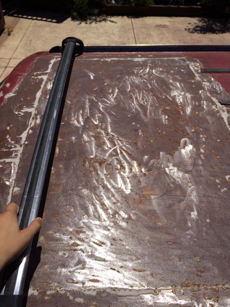

There was a ghetto rigged aftermarket sunroof installed by the PO. So I took that out and filled the hole.

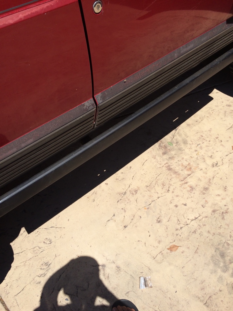

I built my own rock sliders

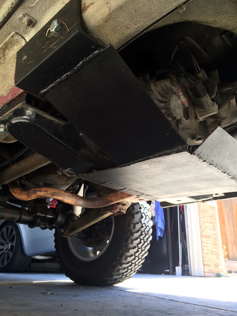

I made my own trannsfer case skid. More on this later.

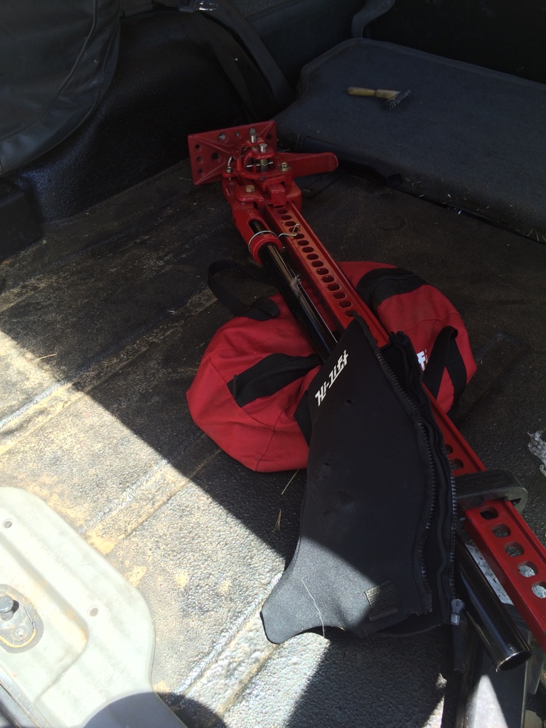

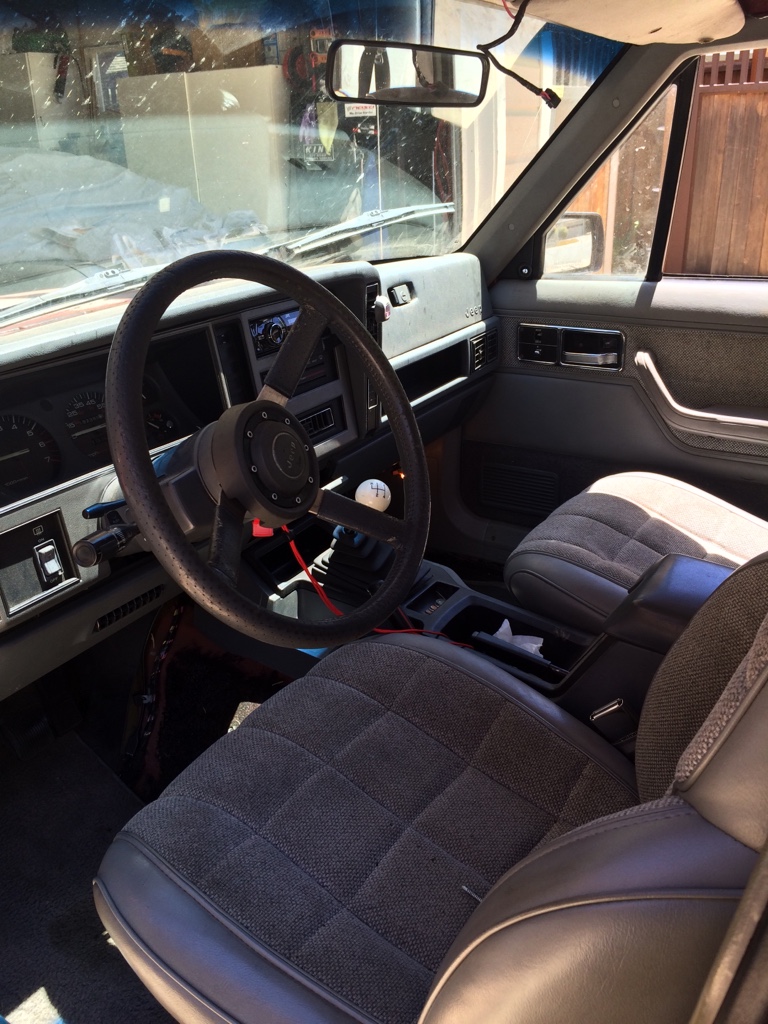

I hurculined my interior, bought a hi lift and winch kit.

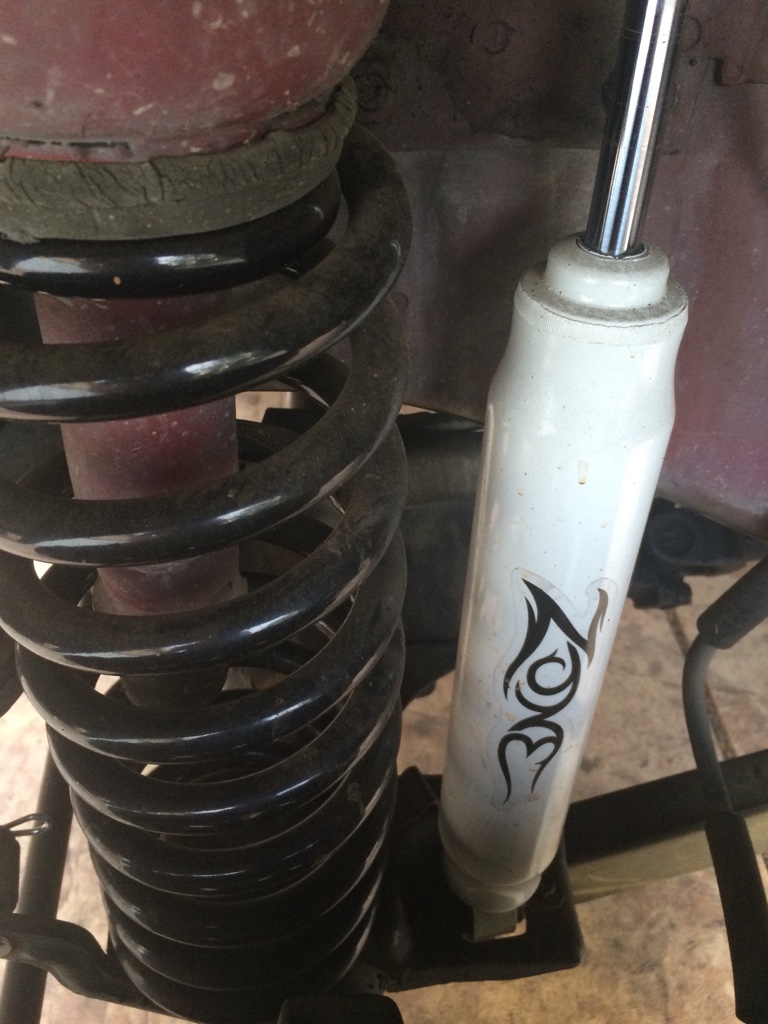

I installed a Zone off-road 3"aal kit. I'm cheap

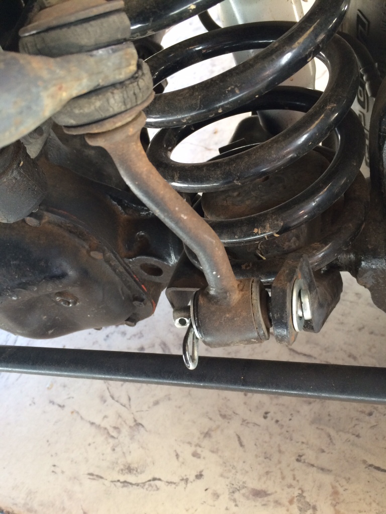

DIY Quick Disconnects

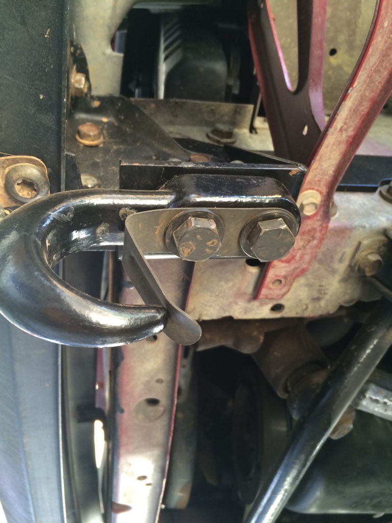

Got some front tow hooks

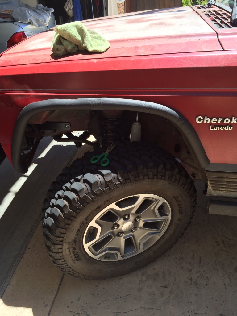

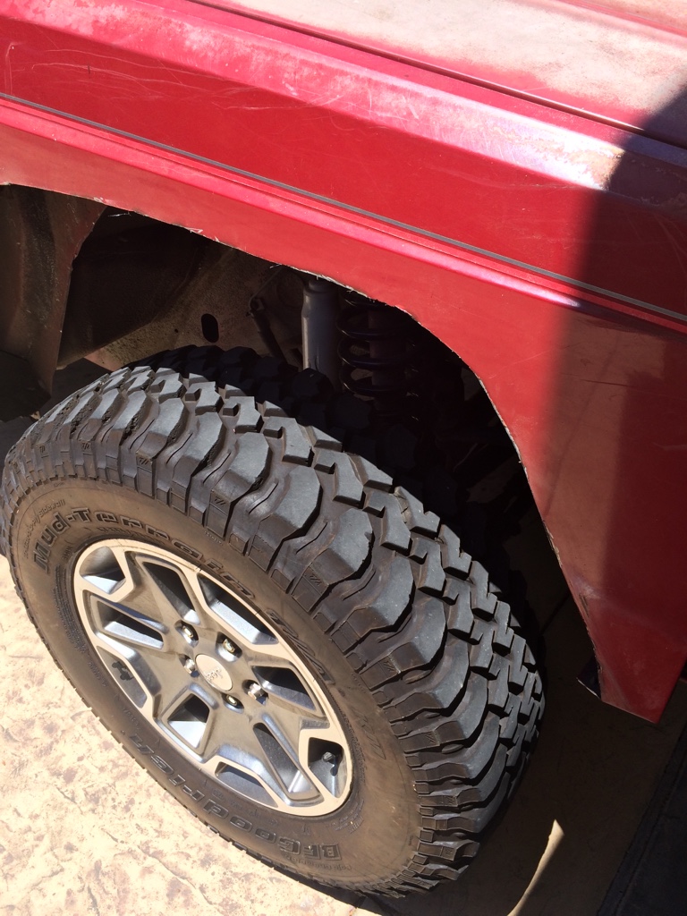

The 32s from my dad's JKR now on 37s going there place on Otis with some 4.4 to 5.5 adapters. I had to cut the fenders a lot to do this.

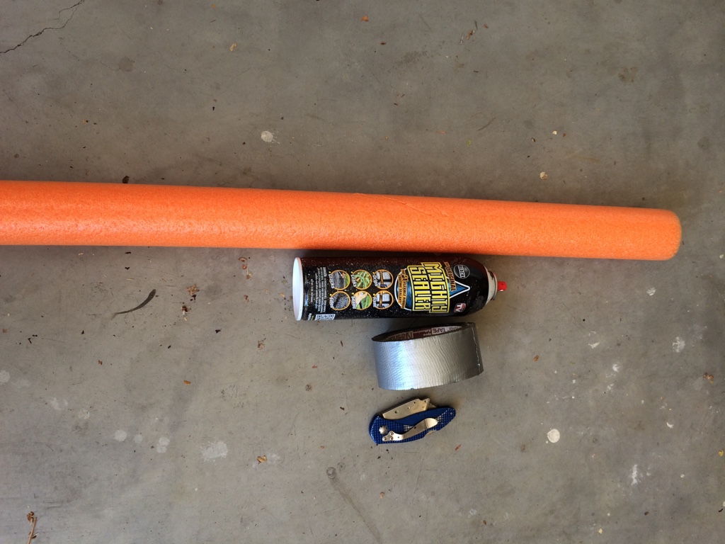

I used the Pool Noodle idea for the inner fenders
My new "flares"

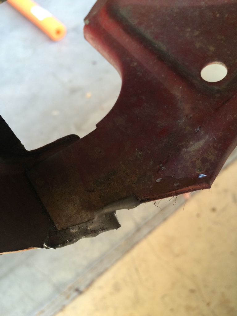

Gotta love JB Weld

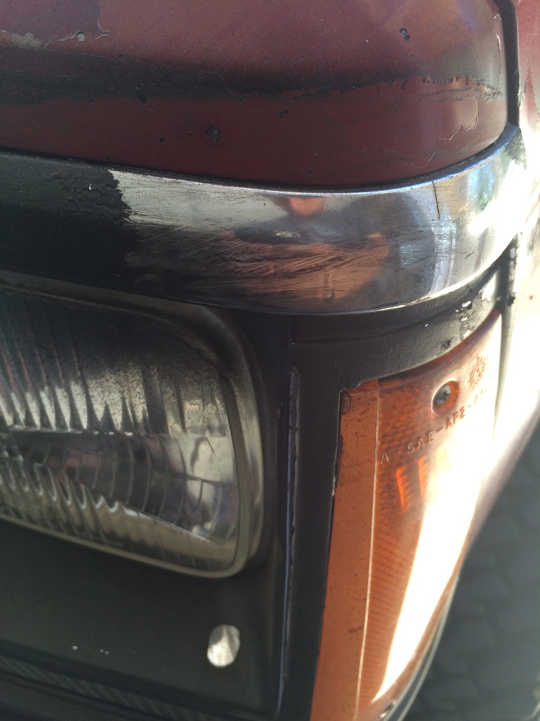

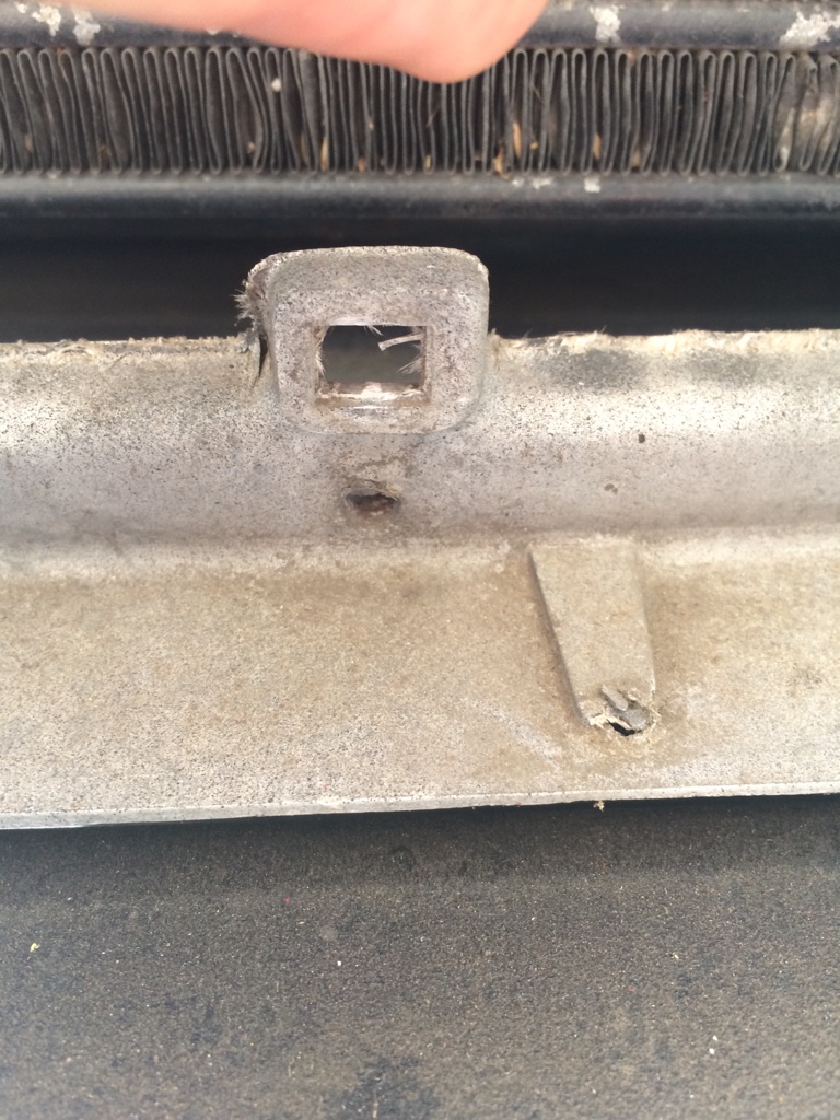

These little black grill things broke off

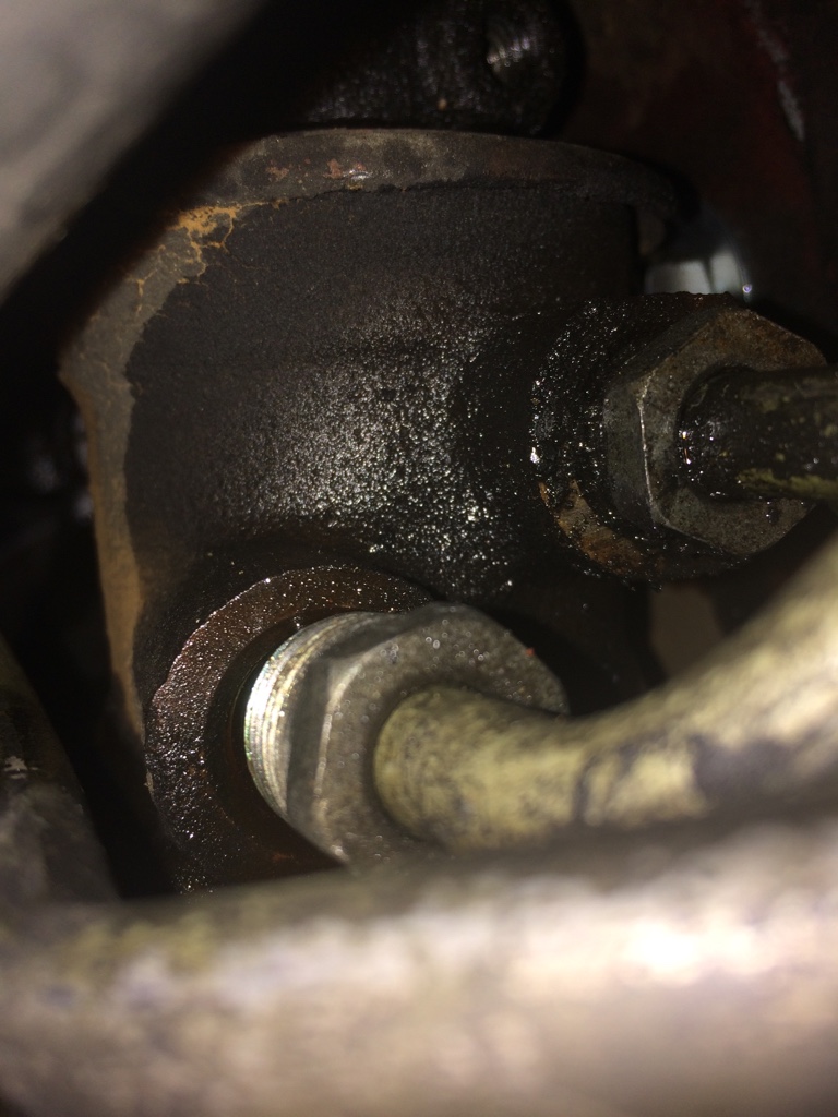

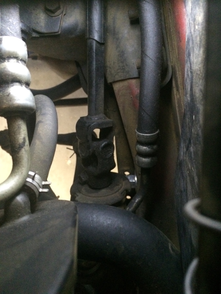

Thanks for the info Rudolp, I would like to rebuild the box if it's not that bad like you say but I have no idea what to look for or if it will eliminate my play. I tried tightening the Alan key shaft a quarter turn with no change in the steering play. So I'm definitely gonna try the adjuster plug. How much do I need to tighten the plug? When I turn the wheel, the input shaft turns but the pitman arm doesn't move so I don't know if that helps. I think the PO tried adjusting the Alan key shaft and messed it all up. Do you know how to "reset" the Alan key shaft by any chance? Like is it 3 turns out from all the way in or something like that?
My steering wheel wants to fight me when making tight u turns almost like its jolting in the opposite direction. I can see the tires doing it as well.
As far as the track bar situation, I don't really have a ton of money being only 15 so the ZJ track bar will have to do for now. I don't have any death wobble yet so when that happens I'll pull the trigger on nice aftermarket one. How hard are they to build and how expensive?
Basically for the adjuster plug you take a flat head screw driver and a hammer to a tabbed locking ring (jam nut) that is around the adjuster plug and loosen it. The you take your spanner wrench and tighten it as tight as it can go, then back off just a hair (id say 1/64th to 1/32nd of a turn). Then use the flat head and hammer to tighten up the lock ring then you are all set!! The alan key shaft can mess up you box, it has something to do with the engagement of the pitman gear which can cause issues. I do not know how to reset the alan key shaft unfortunately :(
If you are handy with a welder, then you can go grab some metal tubes and fab something up pretty quick. Look through the "my hero" build by jeep450r, he has made all his own custom steering. The most expensive part of building your own steering is going to be the hemi joints

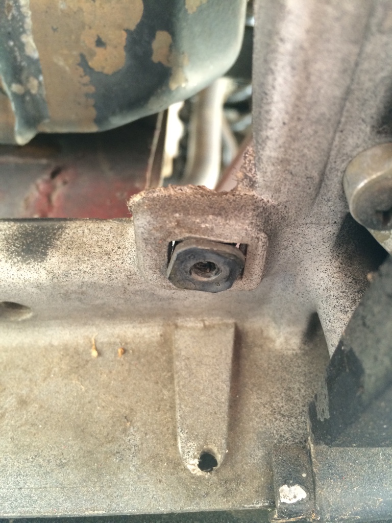

Pull your efan, and be very careful of the spacer against the frame, they break super easily. Also take off the high and low pressure lines at the box and not the pump. After that find a youtube video, bleepin jeep has a good one
I know. That pic is from a long time ago it's all good now. Thanks for the concern tho.
I don't have a Pitman arm Puller so I have to go get one.
I got all the lines disconnected btw
Is there a specific type of PS fluid that I need?
I use ATF in mine, people use autozone PS, it doesnt really matter as long as it is a light viscosity hydraulic fluid. I like the way ATF feels, and if I loose fluid on the trail people are more likely to have ATF the PS fluid. Just dont mix the two!!!! And you are going to need the biggest pitman puller autozone has. Where are you located in CA?
