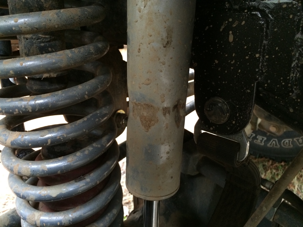

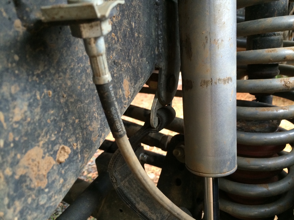

I'm rehashing an old thread here because I'm tempted by these. I have a spring/shock setup and kinda hate it, but maybe I'm doing something wrong.
'95 XJ, 4.5" TNT Long (Radius) Arm, 33's, 4.10's, LSD's front and rear
Whenever I wheel it hard and the front tires start spinning, I get wheel hop, and a hard knocking sound in the front end. I've narrowed this down to the shock bodies contacting the frame. So the axle is rocking side so side a little as the wrap occurs. This is exacerbated a little bit by my choice of where to mount my limit strap tabs, but I relocated the driver's side limit strap and I think the shock still contacts the frame. I do have front stiffeners installed.
So I'm curious- do others have this problem? Is it just the TNT radius arms causing the axle hop? The ORI struts are more compact than just the traditional spring, and the space available where the spring sits is so much larger- maybe I could tolerate the axle wrap, or control it, a little easier with ORI's.
Any suggestions are welcome. I'm aware that moving the limit strap mounts might help some, but I don't think will resolve the issue entirely. You can see the imprints on the shocks here:
Seen that alot with TNT long arms even with good shocks. What shocks you running?
Hehehe- Rough Country. So I'm taking a different route. I've ordered the shock mount conversion brackets from T&J. This will do away with that silly post/ bushing combo up top and it moves the shocks outboard a little. On the axle side, I'm doing away with the factory shock mounts as well and moving them outboard about an inch. This should eliminate all the racket and I'll be upgrading to some better shocks. I'll post up the results.
