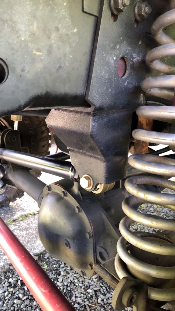

My RE drop bracket (pictured) kicks the track bar back towards the diff while staying flush to the outside against the coil. The ironman4x4 one looks like it drops straight down in the front while staying flush with the coil. Am I looking at the Ironman one wrong?

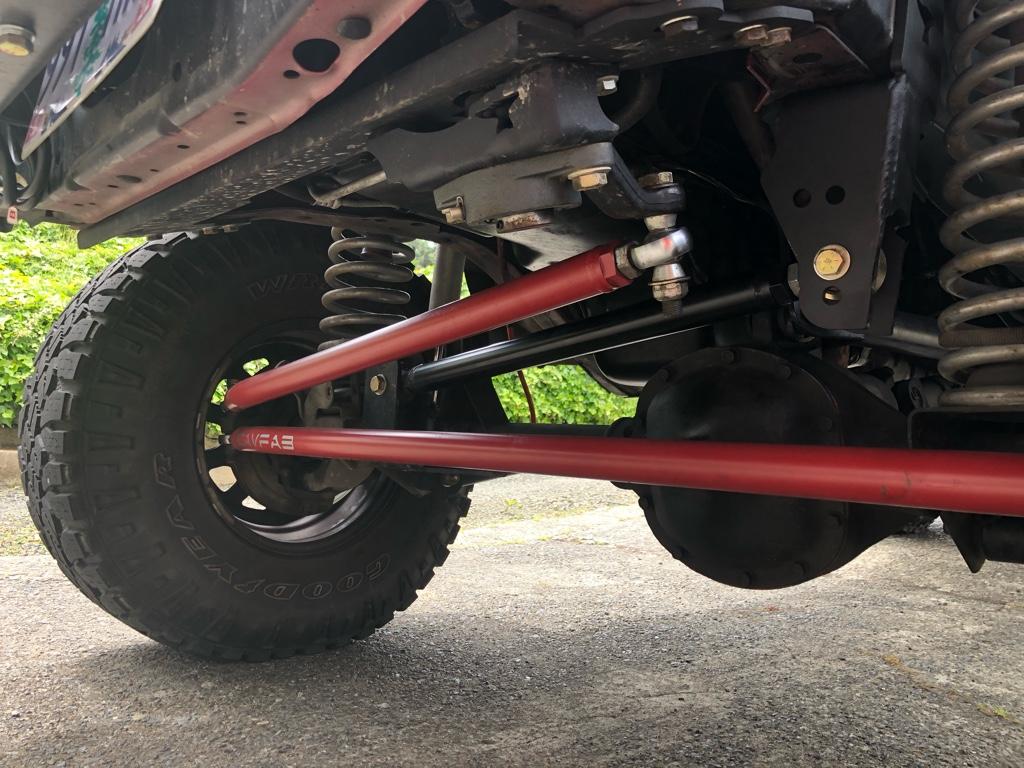

I ordered up the offset trackbar. I’ll have the .625 gap to fill. I’m not sure if I want the bar pushed all the way forward or if I’ll split difference and put a spacer on each side. I’m really hoping I get the clearance I’m looking for.
Offset track bar was rubbing the coil spring so I had to trim a little bit but I got it to work. Happy with the end results. Pushed it forward about an inch.
Thats after you moved it forward?
Looks good, curious if it has bump steer with that much length difference between track and drag.
Length isn't anywhere near as critical as the angles are, and that looks great!

The new mount allowed me to lengthen the track bar 1/2” (1/4” at each end). It’s a cavfab ota track bar paired with their ota steering. The track bar was the solution to the existing bump steer.
As of right now, no bump steer at all. No wondering and no pulling. Really wish I would have pushed it forward a long time ago!
