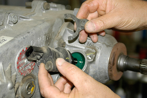

As for the speedo, you just need the sensor (black unit below). It plugs into the same place and instead of driving a cable it drives the electronic sensor. You'll need to swap over the plastic gear (green in the picture, possibly different color on yours) from your cable setup to the electronic sensor.
