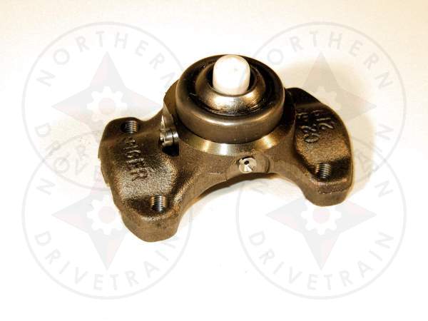

The centering ball that squeaks so much is between the two u-joints on the fat end of the driveshaft. You can see it here, attached to the inside of the left u-joint, with the small zerk in the center, and the dust boot pushed against the right u-joint.
The ball itself is pressed into the piece
When the ball runs dry, it starts squawking
