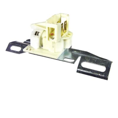

No, I think it is this one (I did not check the year, but you want the head light dimmer switch).
http://www.autozone.com/autozone/pa...9ciat?itemIdentifier=129650&_requestid=241563
Note this text below in the ad:
  • Dimmer switch controls the headlights high and low beams and may also control the headlight on-off switch
  • When not replaced, driver will be unable to change headlight intensity and/or turn headlights on or off
But IIRC the turn signal lever arm attaches, connects and operates a rod also, that operates this switch when pulled forward (not the up and down motion of the turn signal).

Very helpful. Where does this piece get installed. On steering column behind steering wheel or someplace else?
Edit: I found a how to article via Google: http://www.ehow.com/how_5845672_replace-jeep-cherokee-dimmer-switch.html
The switch is in the steering column, but not behind the steering wheel.
I suspect this is the problem for the following reason: If I have the headlight switch on and the door open, the warning buzzer comes on (as it should). However, if I now activate the turn signal, the buzzer sound either sounds like it is dying or changes in some way that is obviously wrong. Since the part is only $11, I will give it a shot after I check all the electrical connections under the hood. Thanks.
Dimmer switch is on the upper left SIDE of the column, about half way to the ignition switch which is on top of the column under the dash.

This switch was not the problem. Replaced it and still no headlights. Still trying all the connectors under the hood and looking for bad ground wires.
