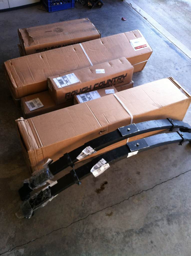

Ordered my rough country long arm lift today for around 1600$.

Got this lift and monstaliner kit on the way, Anybody have any tips, warnings, head's up for me?

Well everything came and I got started. Only had a few hours and left for Chicago early this morning. Didn't plan on breaking all the shock mount studs in the rear. But I did, so I welded nuts in place it should work fine. And the leaf spring/shackle bolts fought me every step of the way. But I got em out all but one I'll have to cut Sunday. I'll try to take more pics but I was by myself last night.
I feel your pain on the shackle/leaf spring bolts. Every single one of mine gave me trouble. Removing the old control arms up front were the same way. I ended up taking a sawzall to those when doing the 3 link, lol. Looking forward to seeing this come together!
Okay so here's what I did to get that leaf off, I cut the packs off so I could round the eye off so it would come out.
Then the new went on easy
I did have to rethread the passenger front leaf hole. It was an m14x20 tap. The inner threads where still good and luckily the tap cleaned it up and worked perfect.
