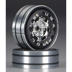

I Love these beadlocks. The added weight keeps the COG freakin LOW...
Well they have half circle steel weights that are held on to the inside center of the wheel with large Orings that do weigh alot...
Like these but in 2.2 You can kinda make it out. These are the Bomb, well from all the ones I have tried in the past.
