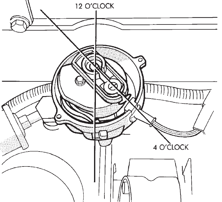

And lastly, maybe the distributor was installed incorrectly. It is possible to install it with the rotor in any old position, only one of which is correct.
The first thing to come to mind is the distributor is installed
out of phase with the crankshaft. The engine must be on the
compression stroke of #1 cyl, rather than exhaust stroke.
Installing a distributor will take some trial and error, first, top dead center cylinder one or cylinder one top of the compression stroke and timing mark aligned to zero. Use a long screwdriver and align the oil pump notch to the bottom distributor blade as best you can. The distributor gears are helically cut so the rotor will rotate some when dropping the distributor into the well and the distributor will fall into the oil pump slot (hopefully), which may take a few tries. The Rotor should align with the cam sensor wires where they enter the side of the distributor housing.

The plug wires also need to be in the correct place. There are many incorrect drawings out there, including the Haynes drawing. Here is a good reference for clocking the distributor and showing the correct firing order. http://cruiser54.com/?p=68
