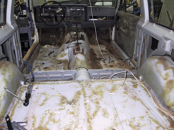

Got all the vinyl flooring out, only thing this stuff is good for is holding moisture under it :tear:
The whole rear area was soaking wet under it and it has been in my garage for 4+ months which has pretty low humidity.

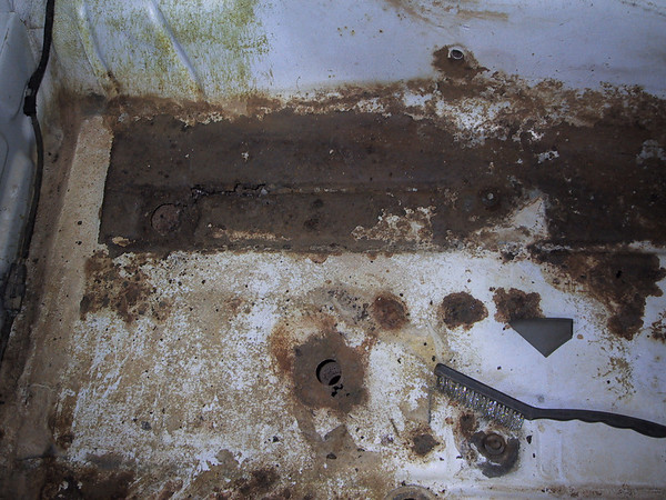

Driver front not bad
Still need to get that goofy firewall pad outta there

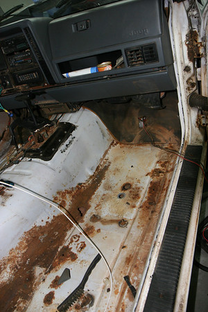

Pass side not so hot, not the worst I've seen but still more work than I had planned on.

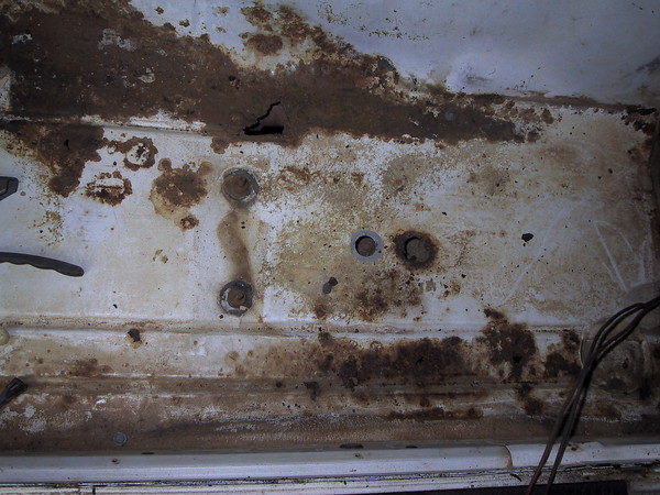

There is some daylight coming in down there...
I'll get after it with a wire wheel and see how bad it really is and how much needs to be cut out.
And the reason WHY it had water in it... That white wire hanging down goes to a NMO style antenna mount that the PO never sealed unless you count the plumbers caulk that was stuck around the base that was all cracked...
Bright side is its gutted and ready for tube
