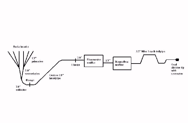

The rear half of my exhaust was already 2.5" so I figured that making the front half 3.0" would be a good compromise. Here's a schematic diagram of my exhaust system as it is now:

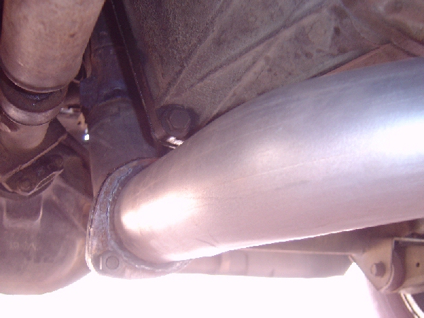

The next piece is a custom 3.0" downpipe that crosses over from the driver's side to the passenger side. It's connected to the header collector by a flanged joint.
This replaced the 2.25" Borla downpipe. Unlike the Borla unit, mine has 45 degree bends instead of 90 degree bends so there's less interruption of exhaust gas flow. My pipe isn't mandrel-bent so it narrows down to 2.75" diameter at the bends, but that's still big enough for up to 300hp.
The downpipe is connected to the center Flowmaster muffler by another flanged joint so with flanged joints at both ends, removal of the downpipe is very easy.

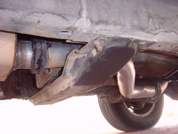

I didn't have any clearance problems with the pipe, but the exhaust shop guys had to drop the crossmember maybe a 1/4" to make room for the flange to thread through the gap. With the crossmember bolted up again, there's enough room to fit my finger between crossmember and pipe, and between pipe and floorboard.
It's all good and I'm very impressed with the quality of the workmanship. These guys also manufacture custom headers and mufflers. I've seen some of their finished units and I have to say, they're pretty damn good.

I've been mulling over the idea of having a header custom built locally, I'm betting it won't cost much more than buying a Clifford and having a custom downpipe built and installed. I'd like some LONG primaries, maybe over 24" that would collect into a tri-Y, then around and into my 2 1/2" catalytic converter. There are a few around that I have found but only for the older 4.2 motor, Hedman or something like that.
IIRC, your pic showed 2" primaries and two mufflers?? Is that correct? WHat type of header are you running, and why two mufflers?
Thanks-
I have a Borla header. It normally comes with 1.5" primaries, 2.0" secondaries, and a 2.25" collector. I had the 2.25" collector replaced by a 3.0" piece.
Why two mufflers?
The Flowmaster was a replacement for the stock muffler back in '96 when my old 4.0 was near stock. The whole exhaust was 2.25" at the time and I had a factory "cherry bomb" glasspack in front of the Flowmaster instead of a cat.
At the beginning of 2004 when I was starting to build my stroker, I wanted to install a 2.5" catback so I bought a 2.5" Magnaflow and Mike Leach tailpipe from Kolak. These were installed in place of the Flowmaster and stock tailpipe, but the result was a loud drone from about 2100-3300rpm and I wasn't happy. The combination of factory glasspack and Magnaflow just didn't work for me. Rather than reverse the mod, I just reused the Flowmaster and replaced the glasspack. It fitted perfectly, got rid of the drone, and I was much happier.
I also though about the idea of having a custom tuned length header with 30" long primaries but the lack of space blew that idea away.

To gain as much clearance as possible from the front driveshaft, I have less than an inch of clearance between the header collector and the oil pan. Having a manual rather than an auto tranny does make things a bit easier. I also didn't have any clearance issues between the floorpan and the tranny crossmember.
