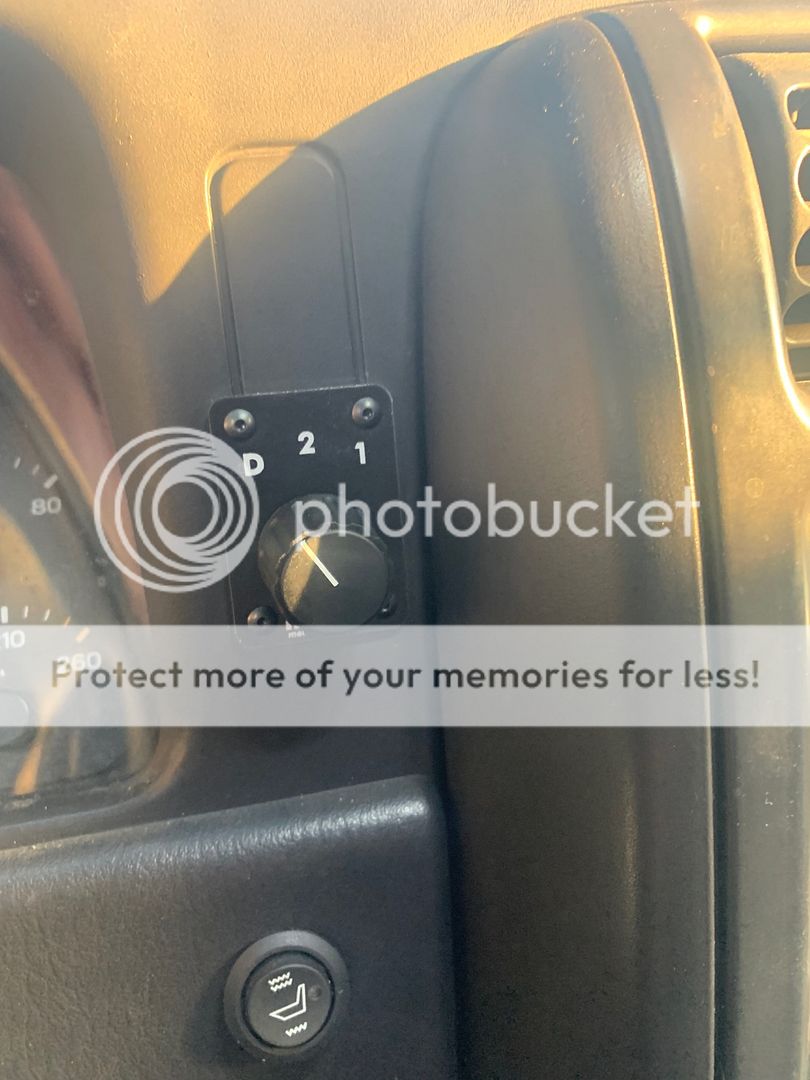

I installed a Montana Fab AW4 controller over the holiday weekend. It should provide me manual control of 1st and 2nd gear. I spent the time to wire it in with 4 pin connectors, so if I need to I can simply unplug it and go back to stock. two 4 pin connectors coming off the new control module, with a power and ground bridge between the two. Two 4 pin connectors where I spliced into the stock wiring - two pins on each side for the solenoid 1 and solenoid 2 controller, and then two other pins on both sides for the ground and power. I'll report back how well it works after I do some more testing!
