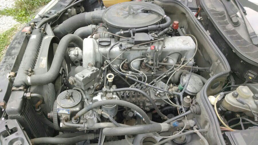

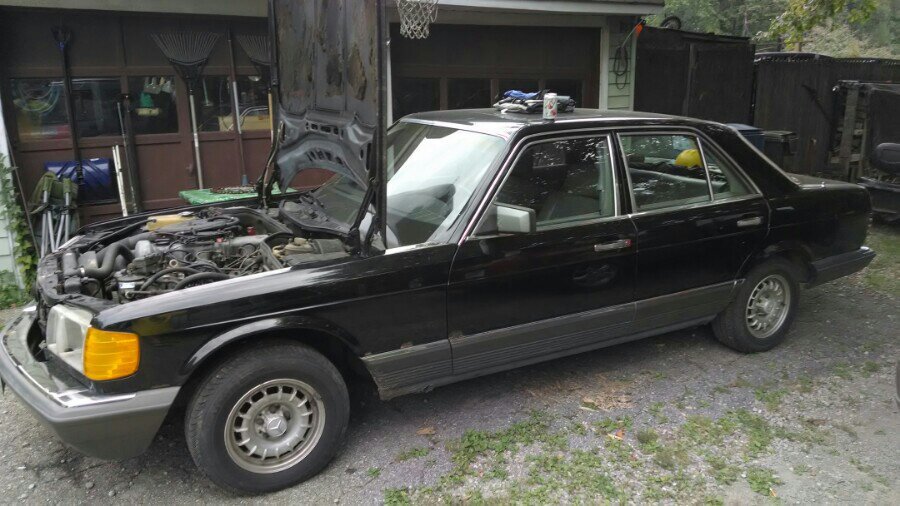

Just got the Mercedes today for $1,000 (very cheap, at less than 160k) so first step is done, now I need to start researching and get started.
It will be a long term commitment, engine runs smooth but needs at least one injector replaced. Plan on fixing everything before the swap. Also, egr on it had been disabled, which is also a great thing. Overall, engine seems in great shape.
Please keep ideas and suggestions coming.
