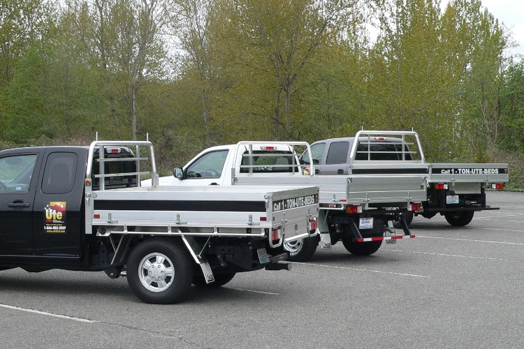

Basically this is how it sits now. Once the weather gets semi decent my goal is to get the flatbed one and the NP435/205 setup I picked up. I will try to keep up to date with this build now that it's present time. Going to pick up a welder in 24 hours, starting to get motivated again, especially since I have a tow rig now.
Nice, I am digging your MJ. I remember seeing it at PA Jeeps and wondered who you were. Yeah, the tube bed is the ticket. The MJ beds (especially yours being a long bed) just get in the way when trails get tight. I had an MJ for a while, and was always real careful with the bed, and mine was a short bed. Good luck with it, and keep us posted on the changes.
Thanks for the input guys. While I would like more of a pickup type bed on the comanche, the tube bed is the route I need to go for what I want to end up with (full exo when i have the fund$$$), plus I have a fullsize pickup. My bed is already trashed from one trip to Rausch and few trip to the local trails here in York.
