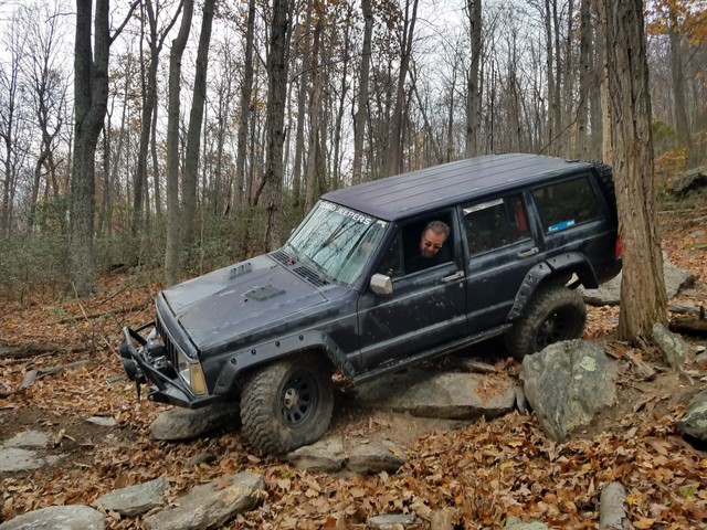

As for the 37s, I'm at 6" of lift and haven't trimmed the fenders since I was on 33s. I don't have much uptravel (~4"), but I stay out of the fenders with it bumped correctly.
