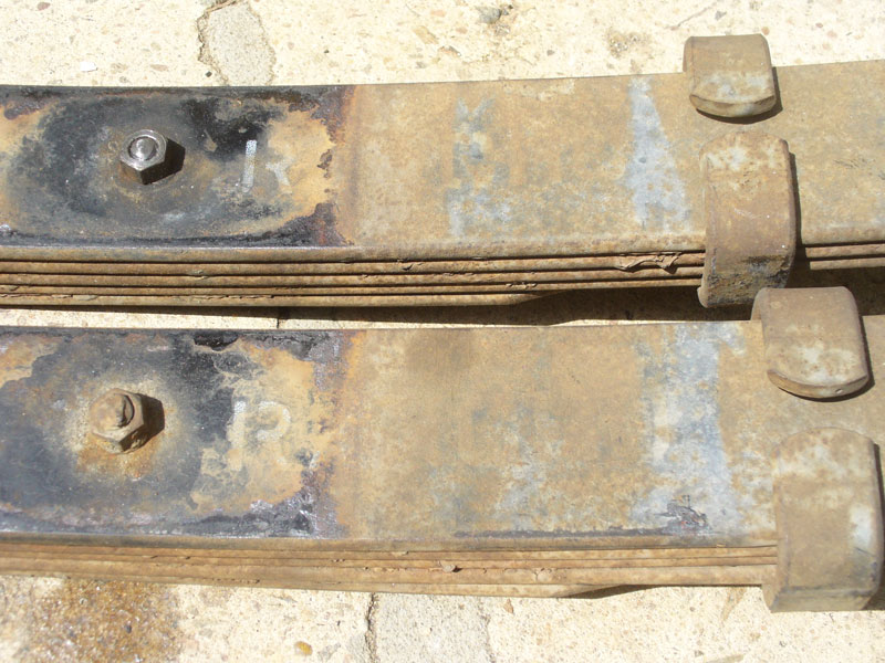

I am also wondering if I should do anything about the locating pin/bolt on one of these springs. Someone did something with it recently:
It looks like it is begging to be welded so it can't loosen up. Would that indeed be the right thing to do?
