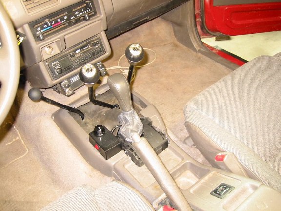

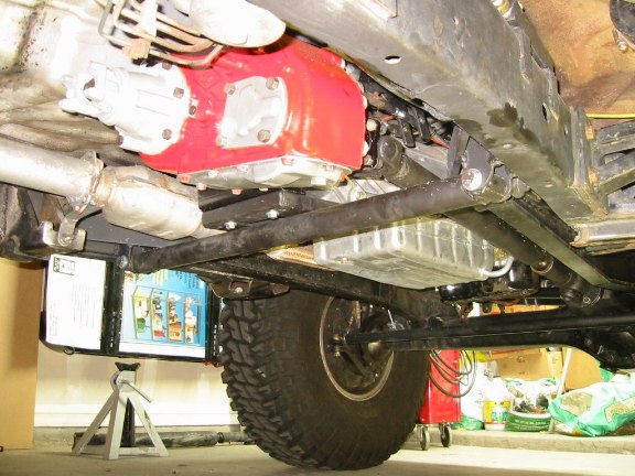

No, not a Jeep. It's an Isuzu Amigo. I wanted an auto tranny and some low-gear options. Isuzu used the A340H in the late 80's with my motor so with that bell, TC and flexplate, the AW4 is nearly a bolt-in as far as the critical stuff is concerned. Not counting the custom cross-members, skids, driveshafts, shifters, etc.
Couple pics:
Shifters:
And underside:
Is it possible to run the stock t-case in front of the klune-v/stronger case so it is less likely to break by the gear multiplication?
Troy
What would you do with the front output? Having the t-case first, with a crawler box behind it isn't really gonna work. Unless you're talking about cutting the front output off the front t-case (turning it into a reduction box essentially) and putting a 2nd t-case behind it.
