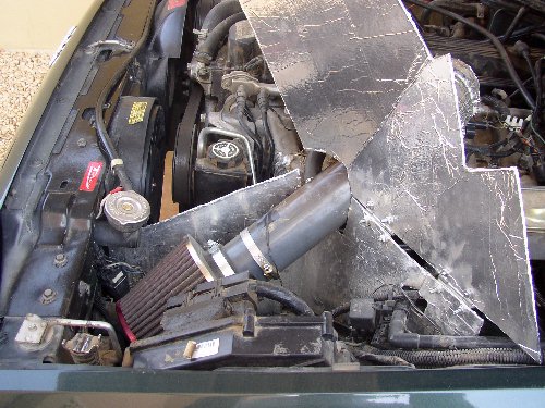

Wait awhile til people get home from work and you'll get more replies; I'll take a photo asap and you can see what I did on my '98.
I plan to make a heat shield based on some other posters' excellent ideas soon.

thats the first one i clicked but theres a boatload of sellers that have the same/similar setups for sale. i just built my own, with 3'' abs pipe and a 8" k&n cone filter, works great for only a 45 intake system. everyone has there own style they like, i would get caught up in the heat shield thing, they can handle a substancial amount of heat and where its postioned your gonna the best amount of cold air flow you can expect.

I got a fake K&N cone filter from AutoZone ($30) and put K&N oil on it, then I got a piece of 3" exhaust tube (free scrap from local exhaust shop) and flared one end out a little. The flared end fits nicely where the stock box used to hook up to the hose and the 3" end fit perfectly into the cone filter. I then cut the stock airbox to shield it from heat.

3" steel exhaust tubing; one 90° and one 45° elbow, 3/16" plate for the flange and a K&N on the other end.
