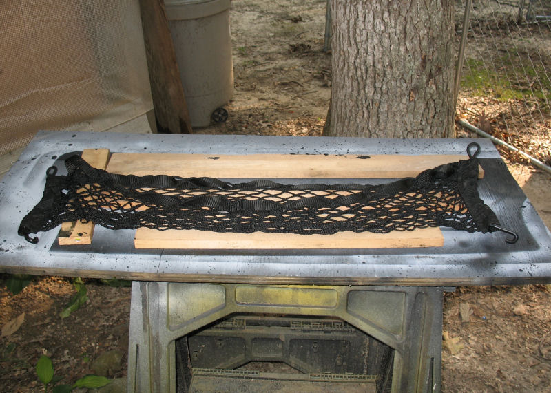

I was at the yard today picking up some more Tahoe cargo tie-downs. These things are great, and can also be found in the late-90s S-10 Blazers (two of these came from a '98). The cig provides reference for size
Also found this in the back of a Tahoe
I don't know if it's from a Tahoe--I haven't seen it in any of them before, and there was a lot of weird parts junk in this one
That netting will be perfect for my current project (sekrit). I'd like to know what it's from so I can get a couple more steel hooks.
