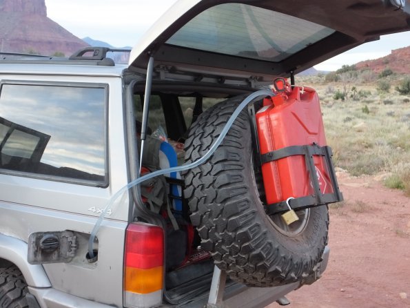

For those of us with rear tire carriers, does anyone know if they make a bracket for mounting gas can(s) along with the rear tire? I have a Detours Tailbone which is great, but doesn't have provisions for gas cans. It seems like there should be a bracket that mounts behind the spare that would allow you to carry a gascan or two.
I attach a jerry can to my tailbone sometimes. I bent some 3/8ths threaded rod into two specialized 'staples' that hold a smittybilt jerrycan holder to the wheel of my spare.
I only attach it for trips where I want the can or where the jeep is very full and I need to put a water can there. With a shaker siphon I can fill up with the can still mounted. I welded a small tab of steel to the strap so when the strap is closed it isn't possible to open the can. This makes it a little harder to steal my gas.

They go through the holes in the back of the jerry-can holder and then bend so they will go through the holes in the wheel. The ends then go to through some holes drilled in some flat stock and nuts are threaded on. The flat stock pulls the can-holder tight to the wheel. It is burried in the garage right now and it looks like I didn't take any pictures while I was making it. This was the best I could find:
i.php
