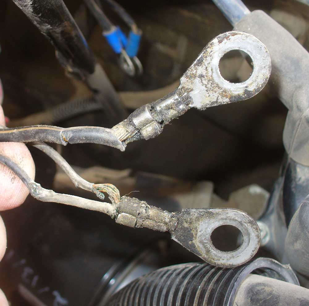

Looking at ground connections I saw that I had several damaged wires going to the dipstick tube stud toward the rear of the block on the passenger side:
The insulation on the larger wire was hard and brittle, indicating a bit of heat over the years.

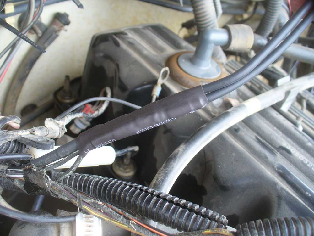

A splice right at the end is a recipe for a broken wire later on down the road. I opened up the harness and worked my way back several inches. This got me to a point where the splices could be supported by other wires, and also got me to a point where the insulation was not so brittle. I joined the two smaller gauge wires together at the splice, and then joined both splices together in one 8 gauge ring terminal.
The splices were sealed with heat shrink, then an additional, longer piece of heat shrink added over that as a strain relief, then both splices were shrink wrapped together for additional support.
Note also that the splices are staggered. Another detail to help keep them from breaking at some point down the line.

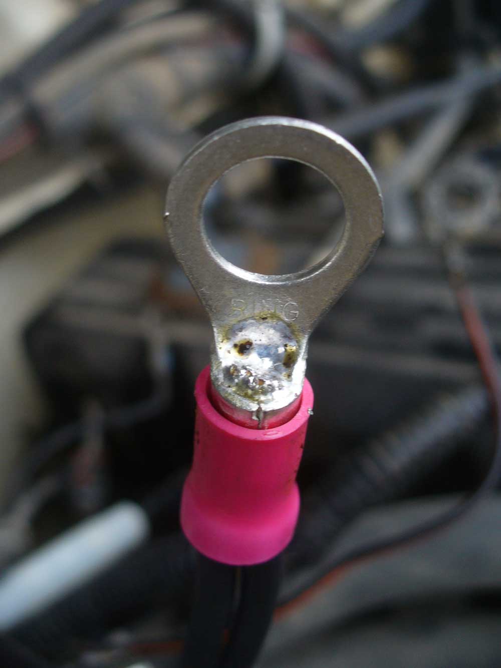

The 8ga ring terminal fits the two 10ga wires snugly. A bit of a crimp and solder should provide a reliable terminal.

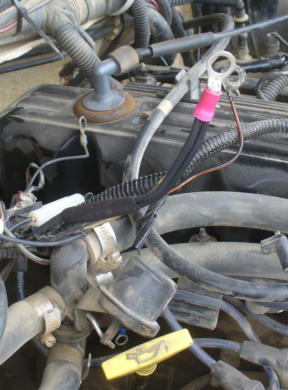

Here the wires are, showing they are terminated at the correct length to match the original configuration.
Finally the bundle was again wrapped in tape and placed back in the factory convolute loom.
