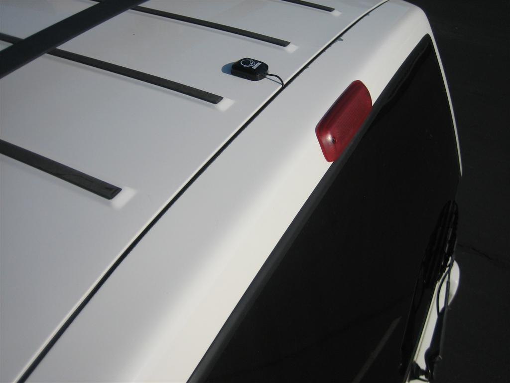

I run a garmin handheld in addition to an external antenna that runs from my tailgate to the center console. That way I don't need to mount the GPS on the dash to get reception. The antenna costs $20.
