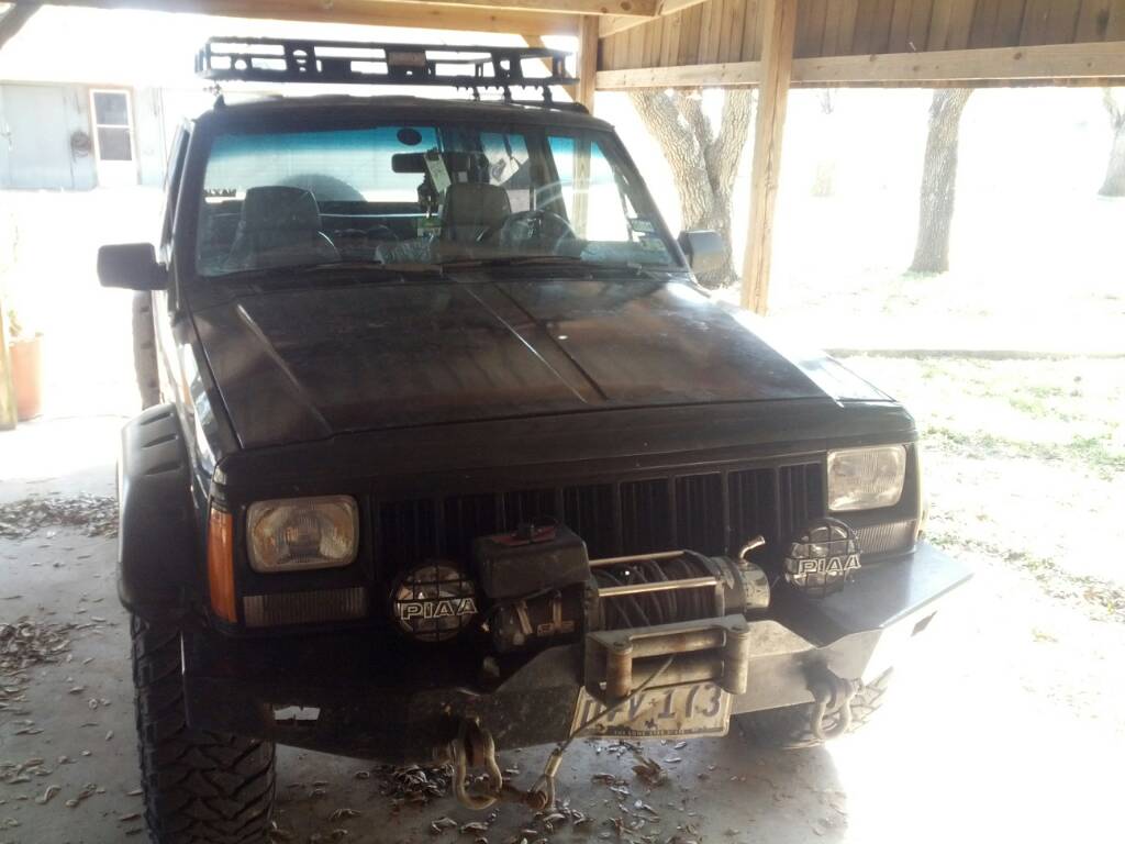

I'm looking into getting some type of led bar lighting from Olympus of road. But I'm having trouble on were it place it/them. I really don't want to spend more than 250$ on this. Here's a pic of the current setup.

With your winch in the way, I'd mount the bar to the header panel just above the grill. If you put it in the grill, airflow may be an issue. If you put it on the roof rack, glare of the hood woulp be horrible.
I want to see more on your hidden winch. Could you start a new thread with tons of pics? How did you bolt it in? from the bottom? How much did you have to cut away from the stock frame cross member? How did you get the lever to the front? 'clocked' the end of the winch? What winch did you use? Do you think that it could fit with a stock bumper and bolt on front hitch?
Placing it up high will produce a better light pattern. I'd consider incorporating it into your roof rack. That's what I did with my reverse light bar, and I'm very pleased with the results.

I've seen a few setups with the monster 40' ones up top. Since money's an issue right now, how about I get one 17' for now, and when I get more saved, i get another and space them equally up top? Only if the glare isnt bad.
The glare on the hood, as one of the other posts stated.

Honestly, I haven't mounted lights up high on the front in years. But after my recent experience with the rear light bar, i just might. I think the key is to aim the lights so that they don't shine down on the hood but hit the ground out in front of the vehicle -- perhaps even out past the reach of your head lights.
Best thing might be to simply experiment once you get your light bar. Wire it up temporarily with leads long enough that you can move it around to different potential mounting locations to see which produces the results you prefer. That's what I did with mine on the rear.
I've been kicking around painting the two raised panels on my hood with rustoleum flat back Bedliner to reduce glare. Might be an option for you if you are dead set on going to the roof. Also I would check your local laws. I know around here the police are not fond of catching you running around the street with lit roof lights.

Given that you have the lights on your bumper, it seems you have forward illumination taken care of. And unless the wildlife you're trying to see is hanging out on the road, you're going to need to see to the sides. I've found this setup works well, two floods and two diffused, pointed outish:

Instead of the bar, I might look into some lights for the roof rack, similar to the piaa lights on the bumper. The roof rack already has mounting points for lights up there. Just for ease of installation.
