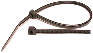

Sooooo I recently got a 00 XJ and I'm swapping all the crap from my 87...blah blah blah...I was giving the truck as once over and noticed some home brew hold downs for the coil pack. When I bought the truck I thought someone just lost the bolts. Come to find out it must have had a head job with a 99 and older head. It works and runs fine but looks janky, any one have a solution?

Can you take a photo of the 'janky' setup and post it?
Hopefully when I pull the valve cover to fix the oil leak I'll check the casting numbers and maybe someone will have been smart enough to put a decent head on it.

It's probably a 0630 head.
