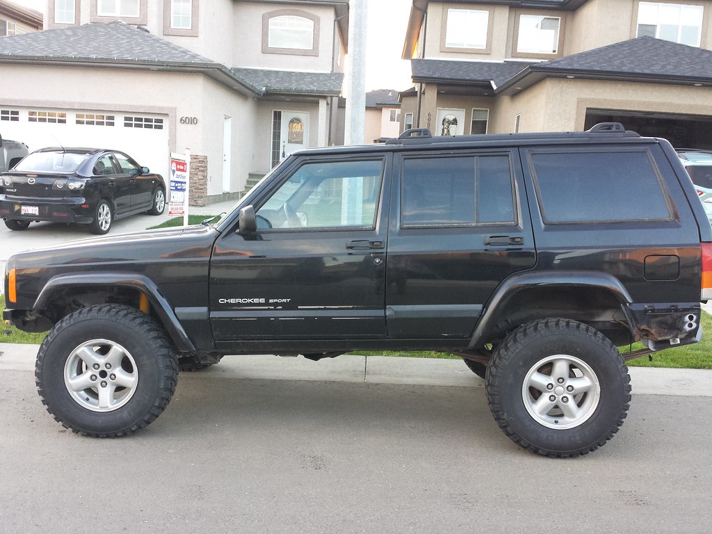

So I am looking to get 4.5-5" of lift and also lots of articulation, or flex.
And I am SO lost at where to go.
I'm new here, and have searched, and while I have read lots I feel more lost now than ever.

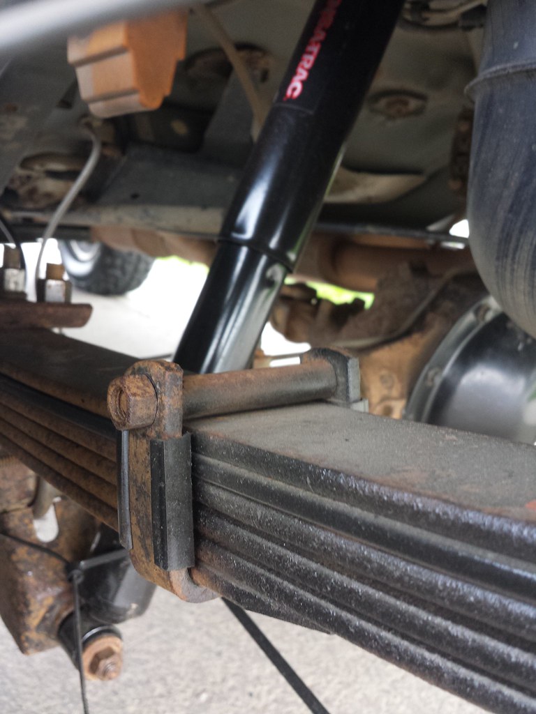

Right now I am running the old man EMU lift, 2.5" coils up front. In the rear I am running their 2.5" full leaf pack, plus their full length add a leaf, it's net me about 5" of lift. I also switched to sliders in the rear. Before I added the extra leaf and sliders I could articulate the rear to have one shock maxed out extended and one maxed out compressed. But now I get nothing, MAYBE an inch difference between the two side.
This is about as much movement as I can get now, there is about 10" of elevation difference between the two rear tires.
Even bouncing on the hitch I can't get it to move much at all. The leafs slide free in the sliders as I put those in first. I am reusing the leaf retainer clips and they are quite sung now.
I am well into the point of tossing my current lift on the curb with a free sign. If I can salvage some of what I have, perfect. But in the end, I just want some articulation, lots of it, but still be planted. And like everyone else I want to spend as little as I can.

Remove the AAL ....it is too thick....wont flex at all
I had the same problem with my OME set up
I wanted 4.5 lift so I removed the AAL and installed longer than stock shackles and shackle relocation brackets
Good flex and nice ride....sporty ride when paired with bilsteins.....
Front I installed Rusty's 4.5 coils w/ clayton's long arms....
But for your intended use I would use drop brackets in the front....provides nice flex/ drop

Typically, the most flex on leafs will come from leaf packs that at normal ride height sit with only a slight arch. An add-a-leaf will give you lift, but not help you get there. Or find a new leaf pack that is made up of many thin leafs that move easily.

I have plenty of flex and I'm at about 5.5. I used a Rubicon Express 3.5" kit, Dodge Ram shackles (junkyard) in the rear to get another 2", then Teraflex spacers in the front for those 2". I have on Chevy 1500 brake lines in the front, which give me plenty of room for droop. I have no front sway bar. I am running JK Rubicon take off shocks. (the two photos of the droop was taken before I got the new brake lines. I was kind of using my old ones as limit straps :nono:)
Looks like the rear springs are too stiff compared to the fronts (due to the AAL) and so now the front does all the work. Remove the AAL. If you need that extra lift, find different springs. I'd also try removing the bolt from the spring retainer temporarily to see how it flexes when the leafs can move a bit more. It should be better but I don't know how much.
A front sway bar like the Currie anti rock would also help even things out.

AAL might be the same thickness.. That does nbot mean it is the same spring rate. It's NOT, it work by dramatically increasing spring rate, making it stiffer and less flexible.
If you want to keep the sliders you are going to need more flexible rear springs. That means a pack with less arch, probably more and thinner leaves and most likely a longer pack. It's up to you which way you go. But you have got to quit saying I want more flex, but refuse to consider doing the things to get the flex. Fact is if you want front end type flex in the rear of an XJ, you will only get there by installing the same type of suspension in the rear as you have up front. That means COILS and long arms front and rear. Leaf suspensions are NOT the most flexy of suspension.

The sliders aren't the problem, but if you want to keep them you need different leaf packs.
Shackles and relocation brackets allow you to remove the AAL, keep the rest of your spring pack, and still get the lift you want.
