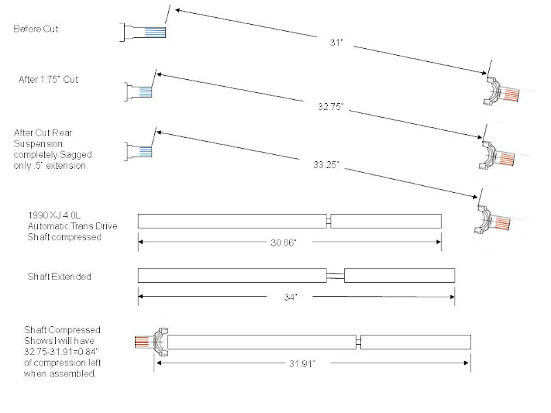

I started looking online for measurements of the yoke, driveshaft, and output shaft. It wasn’t going real well, so I measured everything myself. The attached pictures show all my measurements.
When I put it all together I wanted the back of the yoke to rest on the shoulder of the transfer case output shaft to add some stability and so I would not have to weld the washer to the yoke to keep the yoke from sliding forward on the transfer case out put shaft. Most of the write ups I have seen have not talked about that issue for the newer sealed transfer cases. When I slid the yoke onto the shaft I ground the shaft down just a little, about 1/64” shorter than the yoke, so that when I bolted it down there was pressure keeping the yoke pressed up against the shoulder on the shaft.
The next measurement is critical. The driveshaft must not over compress or extend. I measured the drive shaft and fully extended it is about 34”, fully compressed the catalogs say it is 30.66” and my measurement confirmed it. I sagged my rear suspension and the drive shaft only needed to extend 0.5” so I wasn’t worried about how long it would get. As a matter of fact I can lift it another 3” and still not worry.
In compression the numbers get a little tighter. With 1.75” cut off the output shaft there was 32.75” from the pinion yoke to the output shaft. The drive shaft is 30.66”, add 1.25” for the distance from the end of the yoke to the flat spot on the yoke where the washer will rest on the end of the output shaft. That gives you 31.91” total length. That only leaves 0.84” to compress. Using a little trigonometry it shows that I will only compress about 0.35” with the suspension fully compressed to the bumpstops. That leaves me with 0.49” of clearance in compression and lots of room to extend.

Nice! :thumbup: This is exactly what I've been considering for a while, but was always too lazy to actually do the math and drawings. Glad to know it'll work out well.
Yeah, go-jeep's page is another good one - doesn't give quite this level of detail on some things I was thinking about though (like I said before.) Glad to know I'm also not the only one using a half-inch grade 8 washer instead of drilling a hole in the existing endcap on the slip yoke, though instead of doubling up washers and using a 3/8 bolt I got a 1/2-13NC tap and am going to use a 1/2 grade 8 bolt to keep the yoke on.
That is awesome bro, I have the same yoke fromt he same folks at my house, and I was gong to have the yoke "bored" to slide all the way into the output shaft seal. Have you considered doing this instead of just ending it at the shoulder? Very nice writeup, and great diagrams, that took you some time, and for that I really appreciate it, and I will be using your specs and write up to complete mine. Definately the msot thourough I have seen for the 231 case.

I only have about 1/2" of compression available on the Driveshaft, so I think I may have it shortened another 1/2"

Now you need to go back and do it again.Remove the dust shield and cut the shaft back till the yoke rests on the shoulder.You dont have enough comp left in the slip yoke and it will bottom out!
This is a post 96 NP242, the Yoke is resting on the shoulder.
