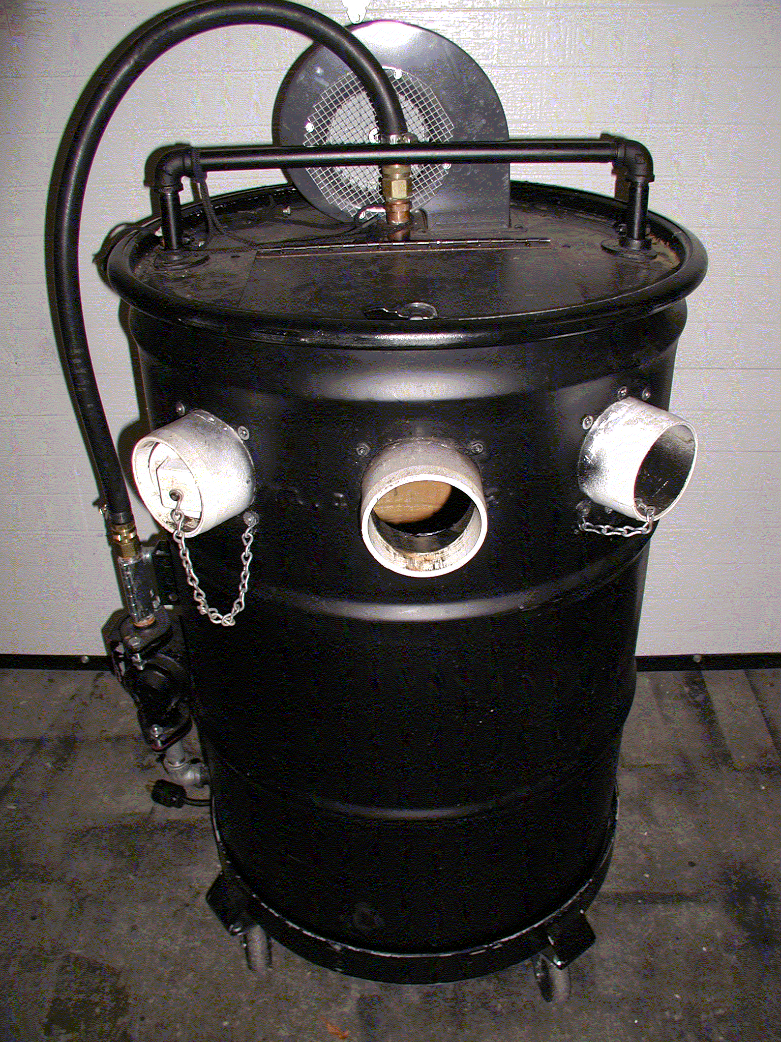

I just built a dry ice fog machine, which looks an awful lot like the picture rockclimber posted. I started with a new 20 gallon drum from McMaster-Carr. There is a 1kW bucket heater from Farm & Fleet to keep the water hot. A basket to hold the dry ice can be lowered into the hot water by a rod through the lid. A 30cfm fan pushes the fog out through a 4" dryer hose mounted on the side of the drum. The first test showed that about 5 pounds of dry ice would yield about 20 to 30 minutes of heavy, low-lying fog. Pictures at
http://www.ifversen.org/gallery/main.php?g2_itemId=488
for anyone interested in seeing it.
