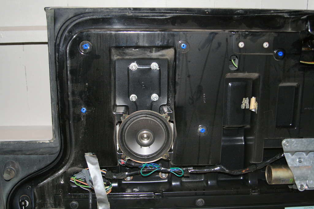

The fiberglass hatch is interesting. It's nonconductive, so I didn't have to worry about the antenna shorting to it. On the other hand, the antenna feed line has to connect to ground at the antenna, so I will have to put some copper tape in the hatch and ground it to the chassis somewhere, probably at the hinges.

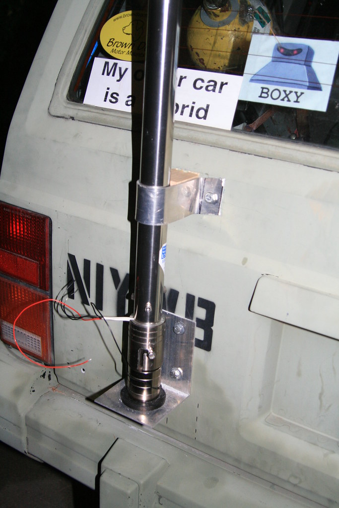

The big challenge for me was the mounting brackets. I'm a computer engineer, not a machinist. But I raided the scrap metal bin at work and found some nice thick sheet aluminum. I was able to fab up an L for the lower mounting bracket using the sheet metal brake at work, and drilled some holes with the drill press.
For the upper mounting bracket, I used a strip of aluminum, and bent it around the shaft of the antenna to approximate it's diameter. I then bent some tabs at an angle using a ghetto setup, 2 pairs of vice grips and a pair of channel locks. I'm really not a pro at this. A block of wood keeps the antenna tight inside the bracket. Normally I'd have to electrically insulate the antenna from the upper bracket and the wood block (wet wood is conductive), but since the tailgate is fiberglass, I don't think it's necessary. A different approach would be necessary with the steel tailgate; even if you insulated, the bracket and the antenna might couple capacitively and bleed RF to ground.
I found some nice recesses in the hatch where I could put the bolts through two layers of fiberglass, which hopefully makes it a bit stronger. I used washers on the bolts and tightened until I heard cracking :D If I have problems down the road, I'll make some sort of backing plate.
It seems pretty strong, I can shake the whole jeep with it and the antenna doesn't budge.

First of all, looks great! I would personally use G10 fiberglas epoxy composite instead of aluminum, but that's because I have some on hand. I also don't like the way aluminum acts when bent sharply, it work hardens very easily compared with steel.
Yeah it's not the most trick setup. The big bracket I put in the sheet metal brake, and it did crack along the bend somewhat, due to the bend radius being too small. I'm really not a metal guy, but I'm trying to learn. Someday maybe I'll fab bracket 2.0. In the meantime, I think it's strong enough. I already whacked it against the roof of my carport pulling out this morning, guess it's taller than I thought :wow: Fortunately it just made a big thunk noise, no damage.
The upper bracket would have to be non conductive for anybody with the steel hatch, which makes it trickier. I've seen some folks use delrin or a similar plastic. Fiberglass would be a good choice also. The bottom bracket is insulated from the antenna by the included bushings, similar to a stud CB mount.

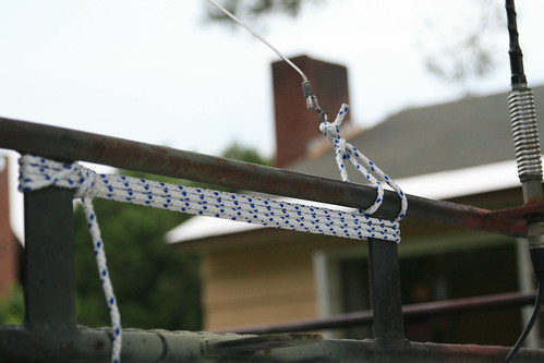

The other option is to tie the whip down. You've probably seen this done before. I'm going with this option for now. It offers the highest possible radiation efficiency on 80m and 40m, and keeps the height down. It also enhances NVIS performance, which really is an advantage for me.

I used some galvanized wire and wrapped it several times around the tip of the antenna. I bent it slightly to keep the coils from sliding down. I wish I knew how to braze, that would be a bit more slick. I made an eye on the end and used some rope to tie it down. I need to change to a lighter cord, that stuff I'm using now is the best they had at Walmart. I left enough slack on the rope so I can untie it from the jeep and let the antenna become erect (huhuhuh) if I am stopped and I want to work DX. Then I just pull it back down with the rope and tie it back off to my roof rack. I should really add an insulator between the rope and the antenna. Dry rope isn't conductive, but wet rope is.

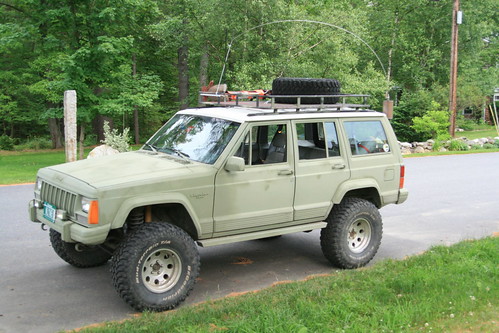

Here are a few pictures of the jeep with the whip on it.
