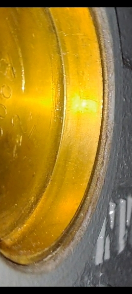

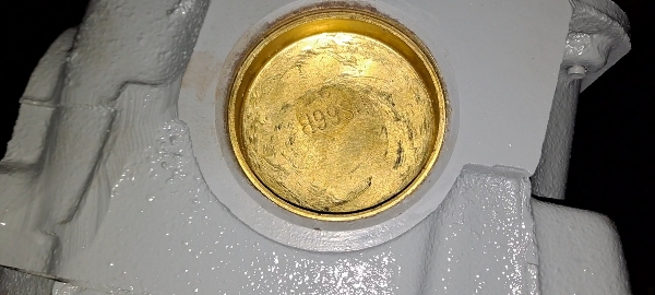

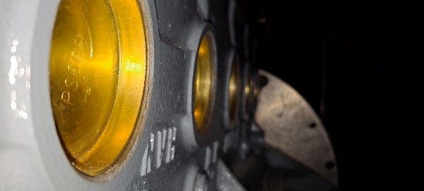

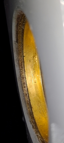

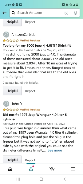

Okay pics suck but iv installed new freeze plugs all around and worried some are too much of an angle and probably gonna pull the one on the back of head because it's got a dent and its angled 😖 just looking for some feedback.. now I have 4 stainless ones I can install but I'm worried this is gonna happen again so i know if I'm good the way they are or? I bought the melling kit from amazon and they were a pain to install more than usual because i think they are slightly oversized by a thousands or something and using a socket I had to really hammer them in hard just to get then to start took me a half a day. I had to redo 2 of them and use stainless on the rear ones behind the flex plate that I got from the autostore just because I was uncomfortable with them but yeah i suck at freezeplugs..
The last 2 photos are the one on the back of the head and the picture before that is one that's on the side witg a slight dent.

Your photos seem to show witness marks all over the cup area. Personally, I would knock those out, confirm everything is deburred, and re-install some NEW plugs (with a sealer), being careful to ensure they are straight and not overdriven.

None of the autoshops around me have a freeze plug installation tool for rent and I had previously bought a nice peice of pvc with backing to drive them in but it wasn't working with the melling kit i think it was too tight of a fit to let the freeze plug flex and there were reviews saying they are slightly too big as well.

It could just be a design flaw somewhere and some are good and some arnt, would explain why some went in straighter than others but they were all tight and took a beating to get in lol. I think if you use that tool you mentioned you'll be alright. If nothing else once you get then in they will never leak lol

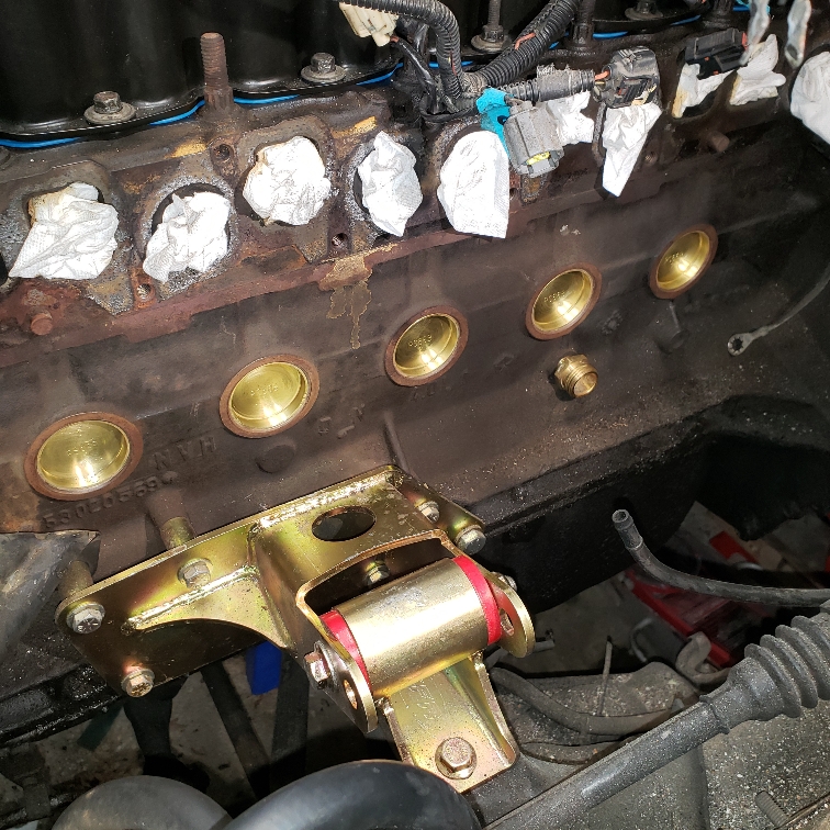

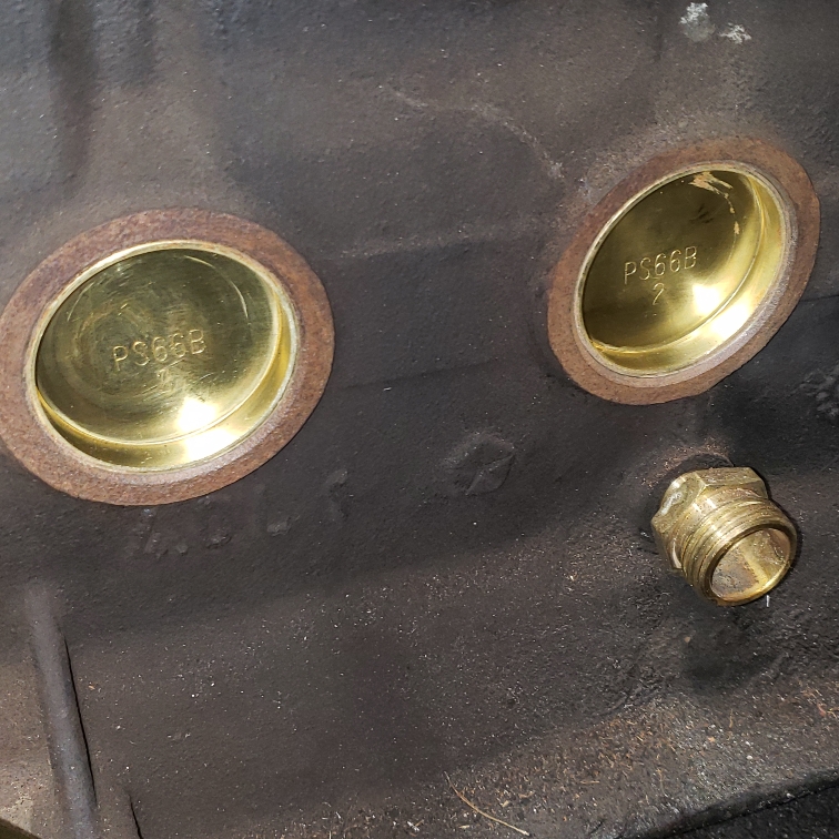

Well, I got two of the 2" Melling plugs in the side (engine still installed), but not before smashing my thumb between the bearing driver and a 4lb mini sledge giving myself the worst blood blister of my life. 🤣 #internalbleeding #forscience
Couple of learnings (so far):
1) I didn't find much of a difference in required installation force between frozen and room temp plugs.
2) The Permatex tended to clump up and not spread smoothly on the frozen plug, so will continue to use plugs at room temp, since I want to use sealant.
3) Bearing driver and heavy hammer FTW. I still had to apply quite a bit more force with the 4lb hammer than I was expecting to get them to move.
4) Start with a much bigger seal driver. A couple of good whacks with the hammer (watch your thumb!) and one side started to seat. I then gently "walked" it in evenly all the way around until the face of the bearing driver was flush against the block.
5) Once flush with the block, I used the 50mm bearing driver to slightly countersink the plug until the edge of the plug rim was even with the taper in the block casting. Relatively light taps with the 4lb hammer were all that was required until final desired position was achieved.
6) Since my engine is still installed, I did not install the "handle" on the driver plate, so I had a little more room to swing the hammer. Start with the easiest plug to get the technique down, then move to the next easiest.
7) For God's sake, make sure the stampings on the new plugs are properly aligned. 🤪
I'll finish up the other 3 plugs when my thumb stops throbbing, probably sometime next year. 🤣
Sent from my SM-G960U1 using Tapatalk
Got the rest in. What a bitch!
Having the engine out would definitely be the time to do this.
The engine mount made that one tricky, and I ended up boogering up that one a bit due to the weird access angles. If that one happens to leak, that's where I'll put the block heater. 😬
