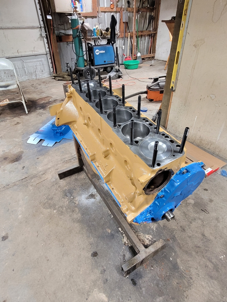

On the '95 it probably does not make a difference. The ARPs do not have the studs to position the valve cover gasket for the 96+. On a stock motor, I'd probably use the Felpro. On a stroker, the ARP. Don't forget that one of the bolts needs sealant. I think #11.
The bolts have nothing to do with the valve cover gasket!
https://www.rockauto.com/en/catalog...0l+l6,1363384,engine,valve+cover+gasket,10710
Yours is an aftermarket VC. I hope the link to RA works. Expand one of the pictures. There are two holes in the aluminum for bolt positioning location. No so on older VC gaskets.
Also look at the head bolts at RA for a 2000. The pictures will show the post to locate the VC gasket.
What your seeing has nothing to due with the head bolts, period! I may run a aftermarket cover but it uses a factory gasket!
devildog, ARP's are not for just strokers, they just provide the best/most consistent/strongest clamping power for the head/head gasket. All other bolts (even the Fel-pro's) have more stretch.
Ditto what RCP Phx said about ARP bolts. IIRC currently available Fel Pro bolts "are use ONCE and then chuck". Reusable high quality ARP bolts, in my view, are the ONLY WAY to go!

Yes, the RockAuto link works, and yes those registration holes are useful for positioning the gasket. My '96 has those, and so does the engine in The Varmints' '97 ZJ.

Uh, no. And that valve cover is an aftermarket. I use that one too. They add the bosses to position that newer gasket. Previously, they used RTV sealant.
The head didn't change, no boss's were added to it! I was running a factory valve cover originally with no modifications required to run ARP bolts!
