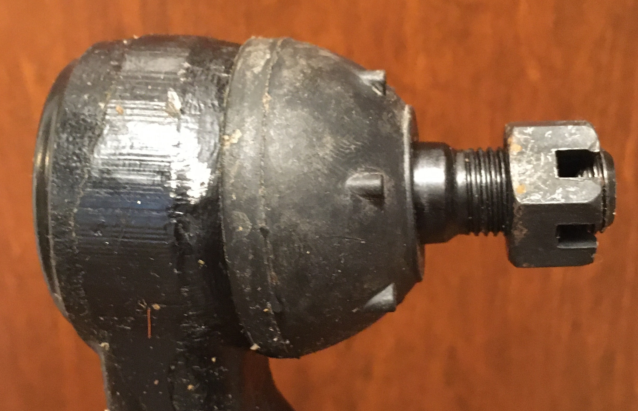

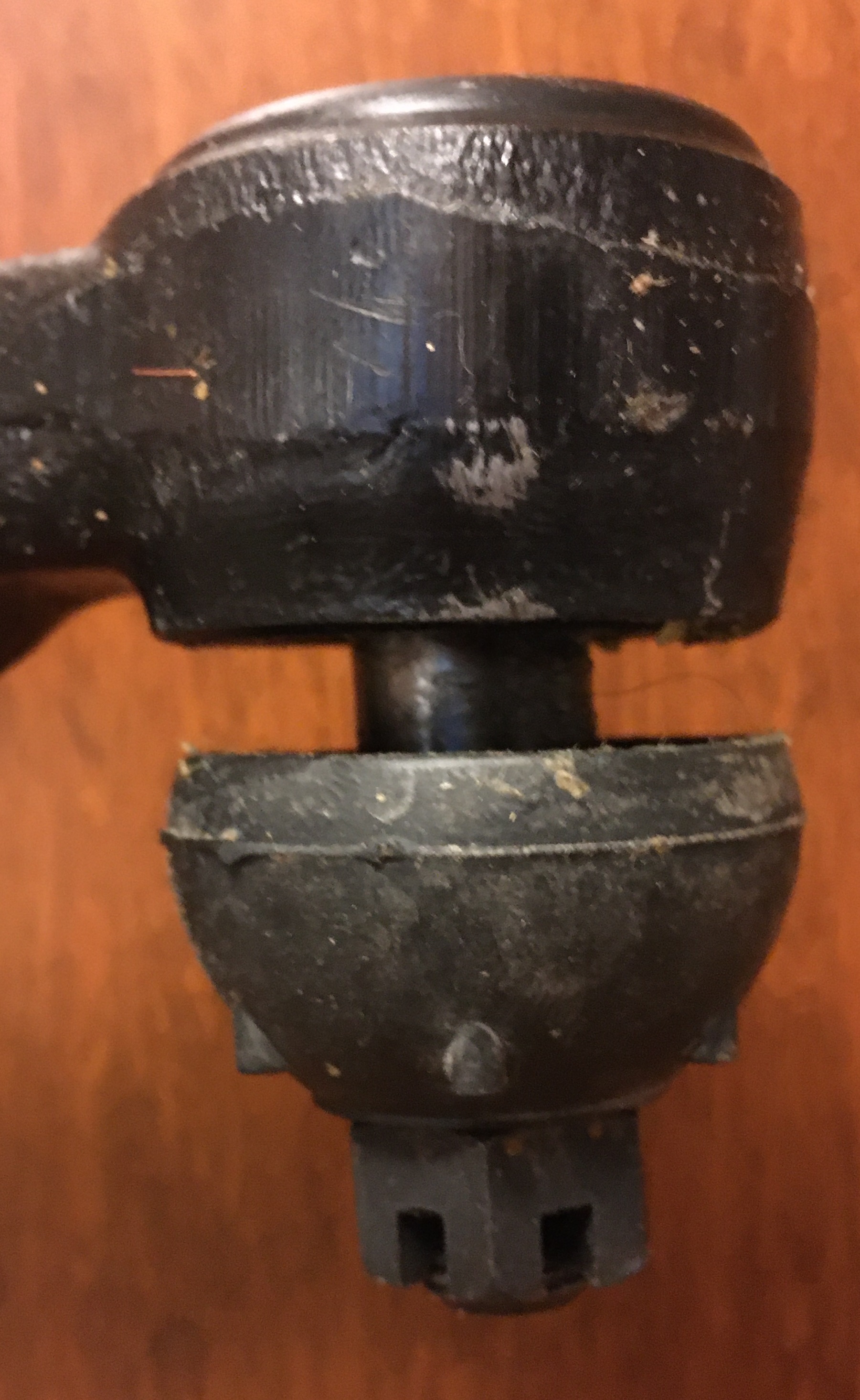

I haven't seen any of these newer design grease retention cups yet, and I want to make sure I didn't receive a defective replacement track bar. Is the rubber cup I'm seeing separated in the first pic supposed to 'seal' up and sit closer to the bar after installation, like in the second picture? The cup lip is sitting outside of the track bar lip here.

As to the grease shields, yeah they position like you have them in the second picture.
