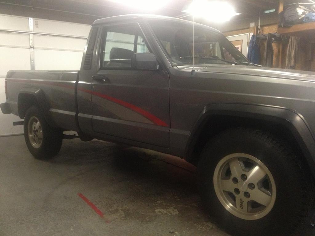

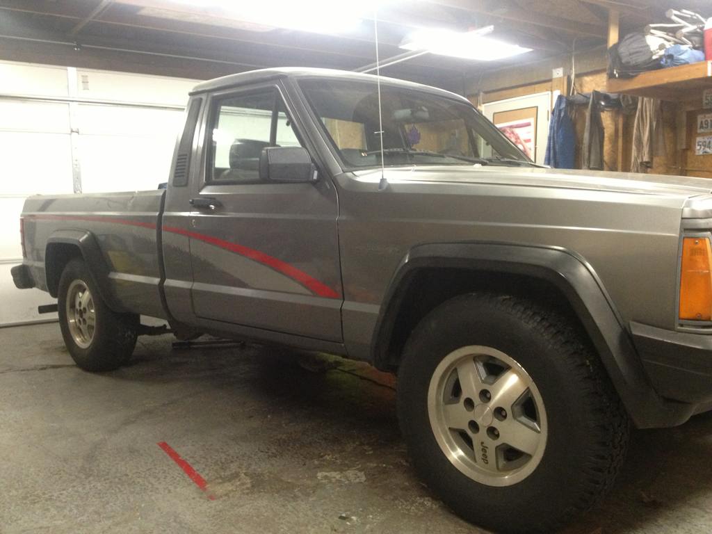

Once I got it home, I washed the outside, then it sat for a little while.
I took the truck for a few drives, mostly trips to the dump or just around town.

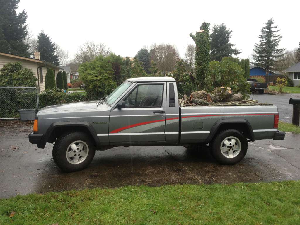

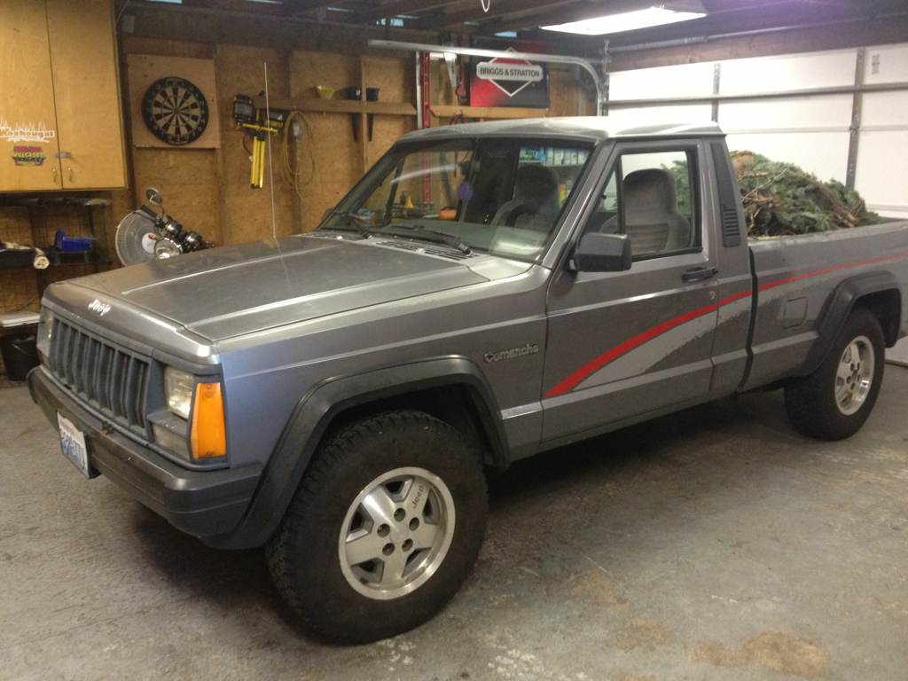

Then I used the truck haul off the debris from a tree on my property I cut down.
This is the first load;
This is the second load;
You might be wondering, why is it in the garage? Well the clutch/slave issues I had been dealing with since I bought it finally caught up to me. About 20 feet after I loaded the truck, I lost all pressure in the clutch pedal and had to move it into my garage using the starter. I had only put about 300 miles on the truck since I bought it in September.

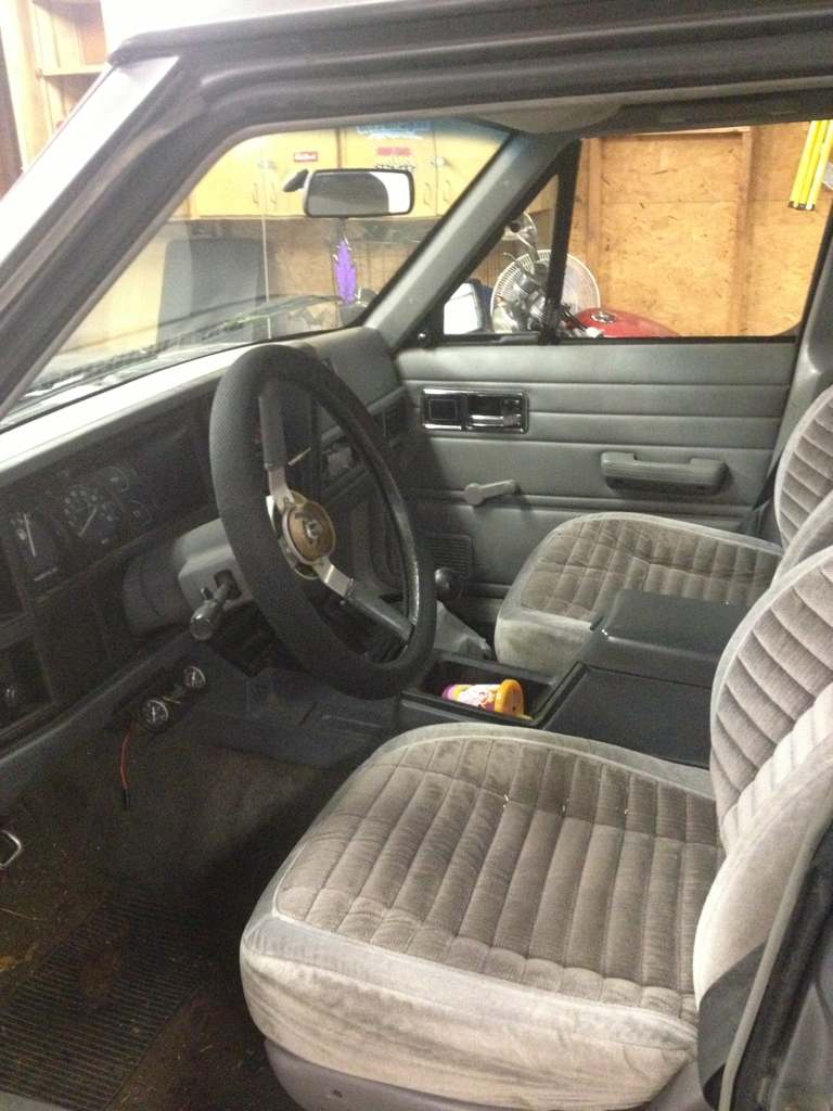

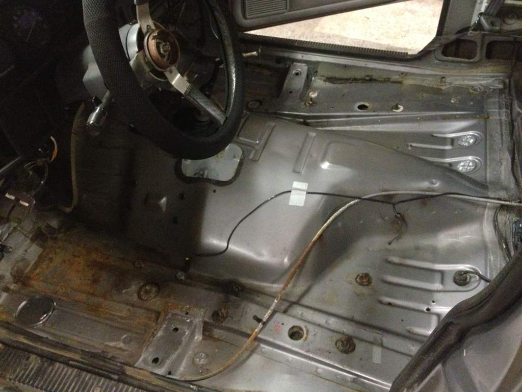

Well that was only held in with one screw and it was in rough shape. So once that was out I decided to remove most of the interior. Especially the ZJ seats that the PO swapped in that sat crooked. Carpet is in pretty good shape except for a wear hole under the gas pedal.
Carpet up;

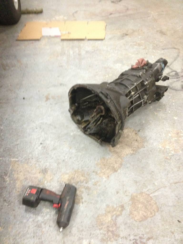

Once that was done I got the transmission pulled and that's where we are right now.

Were the WJ seats mounted to the original MJ sliders?
Bike is an 81 CM 400, and is my winter cafe racer project.
The ZJ seats were on the ZJ sliders, with some ghetto fab brackets on them with self tappers through the floor.
No wonder they sat crooked. Are you gonna try to keep the seats but mount them different?
The truck looks awesome BTW. I wish the body and paint on mine looked that good.
I've got a bench I'm going to try and repair in the next week. I like a bench seat in a single cab.

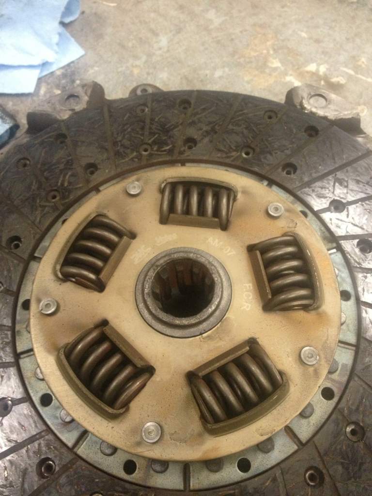

When I pulled the old clutch and slave I didn't see anything that screamed failure, but on closer inspection I noticed that the splines on the tranny side of the clutch disk were broken.

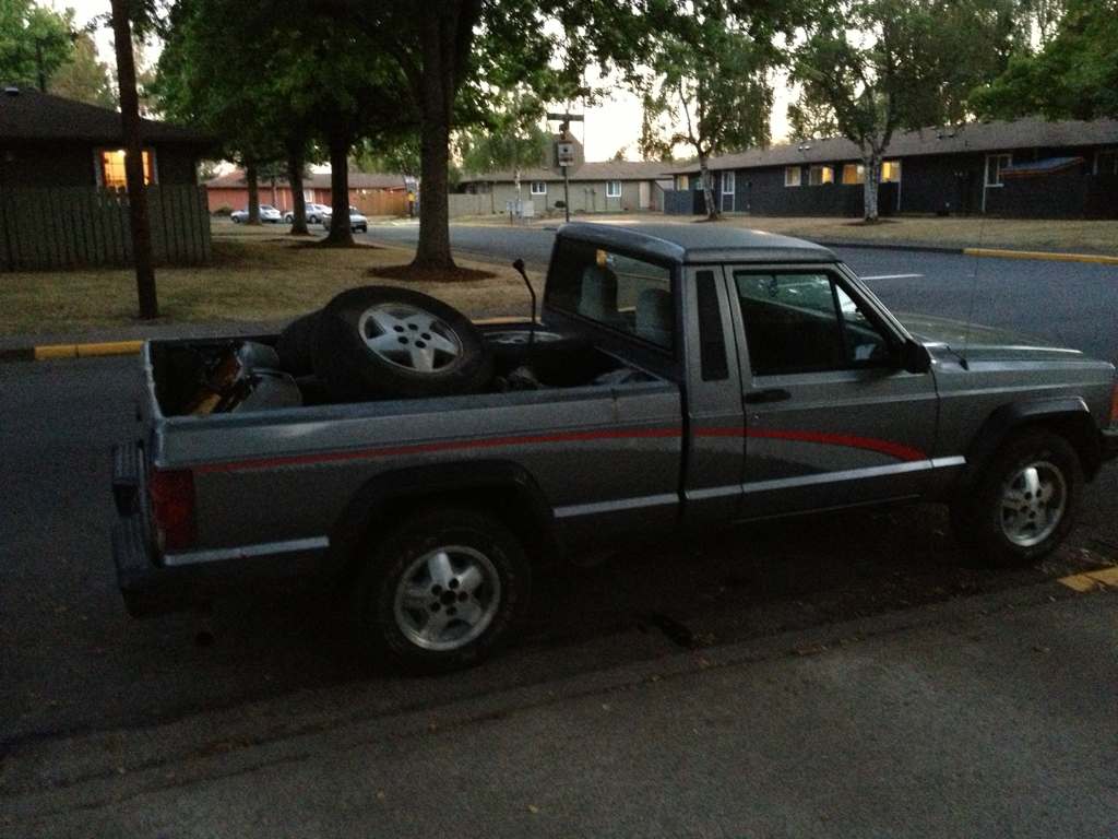

I got the clutch all done and the slave bled properly. So I was finally able to haul the garbage in the bed to the dump.

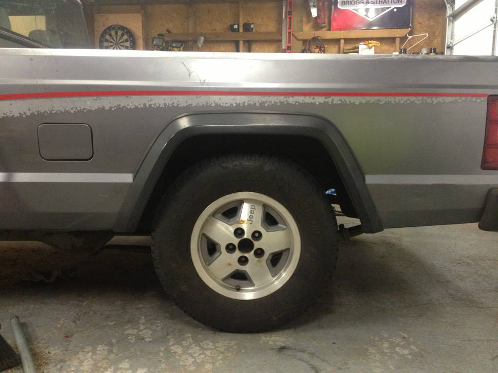

I also decided that it will probably be a while before I do a 4wd conversion on the truck, so I might as well do something to the stance in the meantime. I did some research and decided I could lower it for almost nothing.

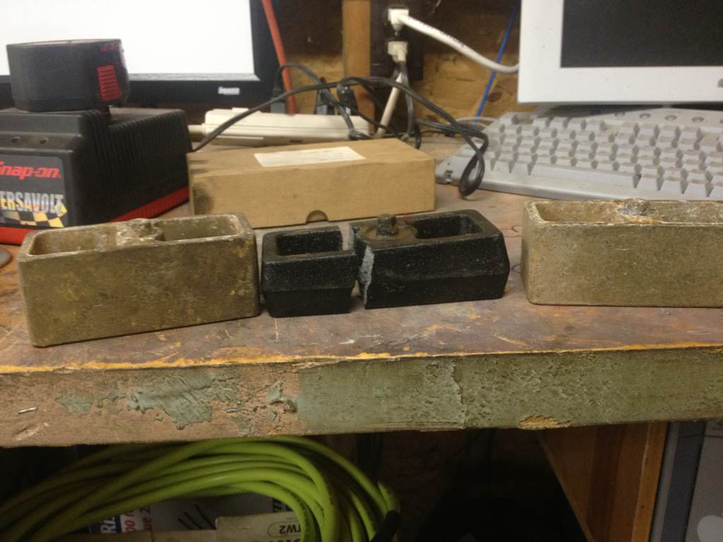

So I got some 2" blocks and XJ shackles to drop the rear 3". I blew up one of my cast blocks before I even started torquing the u-bolts down. So I got on Craigslist and found some blocks about 20 miles away for $15. These were aluminum.
I got those blocks in and decided to put the vehicle weight on the leafs before final torque. Which according to my Haynes manual is 82ft pounds for a Comanche. One of my newly purchased aluminum blocks blew apart long before reaching 82ft pounds. Damn. After closer inspection, I believe the reason I'm breaking blocks is that the Comanche leafs have quite a curve to them, and the perches are actually curved to accommodate this. So I'll have to come up with a solution to this.
Anyway here is a before and after shot of the rear drop.
a wheel well shot;
I think I'd like it down another inch or two. Three inches just isn't enough.
I lowered my 2WD MJ when I first got it, and ran 16" wheels off of an XJ, with 245-50-16's in the rear, and 225-55-16's in the front. I happened to have the tires around, so I used them. I used a 2" solid steel lowering block in the rear and XJ shackles, and it worked fine. I cut the front springs and dropped the front almost 3". I swapped in poly bushings into the rear factory springs, and used poly bushings for the front sway bar, and it really turned into a great handling little truck. Maybe a tad stiff, but totally tolerable for long drives.
