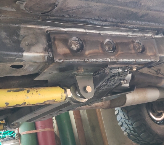

What are you guys thoughts on front frame stiffeners?
Roughstuff is 3/16 thick/ 4.76mm, do not wrap under the rail, 85$
IRO is 10 gauge / 3.57mm, these wrap under the rail to, 180$
Ide probably make my own but thats a lot of cutting, notching, drilling and different sheet sizes to use without a plasma cutter.
Am I splitting hairs on the choosing the thicker material for RS?
Any thoughts on how each are welded on and the difference those welds might have related to the stresses seen?

I installed a full set of IRO's on my 99 earlier this year. Fit and welded up nicely. Seemed thick enough for me. I think the IRO center section is 3/16". I though the difference in thickness was marginal.

A necessary evil for lifted XJs that wheel. I'd go IRO only because it will wrap underneath as one piece. The unibody is already paper thin so everything helps. When my XJ bit the dust I cracked on the bottom right of the steering box. I had a pair of IRO stiffeners I was going to put on but scrapped the XJ for the MJ. My MJ has IRO stiffeners. I didn't install them but other than the rosette welds, weird angles and welding metal to tin foil it's not terrible.

I found it interesting that RS has horizontal weld areas vs the typical plug welds/stitching of others. Are there any pros/cons to this?
I dont like the little tiny plug welds.
I like 1.5"is circles. Not sure i like the long vertical welds either. But not sure any do this. Maybe stinky fab
The IRO's do match in the front. IRRC, the rears have a fish plate of sorts.
With that being said, I chose to add some additional support to the front seam. I just welded some 1-1/2" wide 1/8" flat stock over the seams for some additional strength. There are any number of ways to add support.

I did a mixture. I have Hooligan on the rear. IRO for the mid. and Ruffstuff for the front. IRO vs Hooligan, flip a coin. I do not have the Hooligan mid, but I think it wraps under and a bit over to the 45 degree. The Ruffstuff had holes missing. I think to spend the extra money and be time ahead.

I did get a rear section of IROs. I think they are 10 gage. I believe the set of IRO center section was 3/16". Check their website to see if they sell both. One plus for the IRO rear over the Hooligan is they provide a cut out to fill in a section when the stiffener is bent. Small potatoes to me, though.
Also, I used T&M inside frame stiffeners. I went 10 gauge with them.
