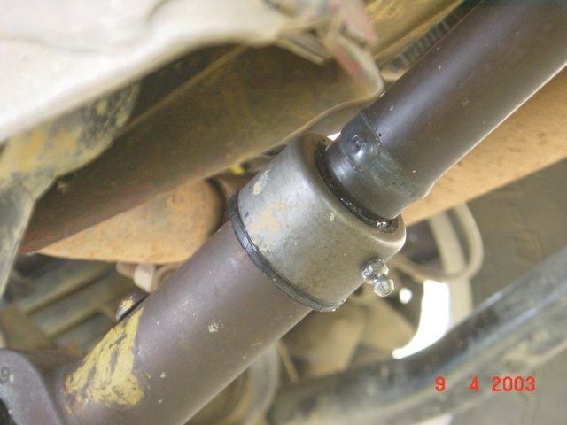

what did you have to trim?
I had to shorten the driveshaft, since it was bottoming out on compression.
Before:
After:
Then, when I added the RE drop brackets, I had to re-lengthen it, because the brackets pushed the axle forward.
