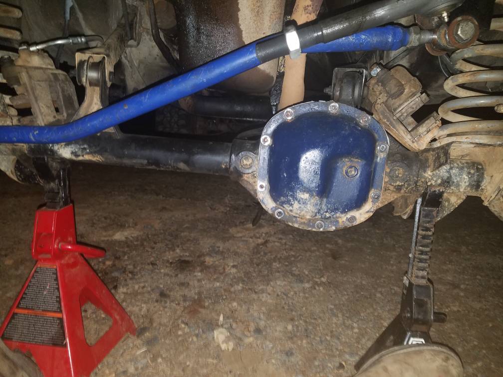

Tonight I installed/fixed the locker, works like a charm now, also installed my new ruff stuff cover, pretty decent progress for on your of work, got the steering staged for paint, as well as the long arms and crossmember/t case skid
