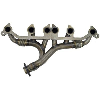

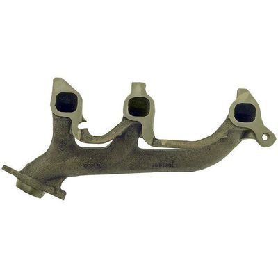

You can definately see how much material was removed from the 91-99 manifold when they went to the 2 piece setup. Is it possible to just get one of the earlier manifolds then drill a hole and weld in a couple of O2 sensor bungs?
You cound probably mod a single piece manifold, adding an O2 sensor bung on each side of the "Y" connection, thereby giving you a front and rear O2 read. You can get O2 bungs from exhaust shops, or on line from places like Summit or Jegs. I'm not sure how well it would work putting the 2 downstream sensors behind the single cat. It might work.

I agree with this method. Putting two together before the cat, and two together after the cat should work. You may just need to extend the 02 sensor wiring to reach where needed.

You can definitely see how much material was removed from the 91-99 manifold when they went to the 2 piece setup. Is it possible to just get one of the earlier manifolds then drill a hole and weld in a couple of O2 sensor bungs?
Yes, that is possible! What I would do is drill the hole, then weld a grade 8 nut over the hole so that the c02 sensor could be replaced if needed later. That does solve that problem, but as you can see by your images, the single manifold attaches to one exhaust pipe. I have two cat converters that has to attach to that single manifold, and I'm not sure how to make that happen. I guess I could get the older manifold and let the muffler shop figure that part out. He could make a "Y" piece to attach the cat converters. I will ponder on that idea as I stop by the muffler shop and ask Steve if he can make it for me. Thanks for that idea, it may get the car going again sooner than looking for a late model head. So far I have had no luck locating one. The scrape yards are not willing to part with the head from a good running engine.
