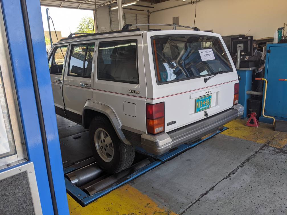

So I went and got my new 92 xj from Texas. drove her home.
Went for smog and passed everything except for the fuel pressure test.

Pic of the new project. She's decently clean. Still needs full paint correction and a few dents pulled... I'll start on this in a few months
