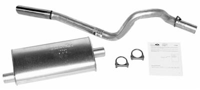

Anyone know what the diameter of the tailpipe is? I cant seem to find it on the website.
exhaust is 2.25 after cat. At least stock.
So my Dynomax kit finally arrived on Friday and I installed it on Sunday. Getting the old muffler disconnected from the cat was the hardest part. I didn't want to just cut the thing off in case there was any issue with the Dynomax kit, but ultimately I ended up cutting it. I would recommend just cutting it off to start with...save yourself some hassle. The new exhaust went on in like 15 mins...seriously. It fits well and it sounds great. Nice smooth tone that is deeper than stock and I find that it's actually quieter while cruising on the freeway. At low speeds (under 35mph) it does make some noise in the cabin at the right RPM, not annoying but it's there. And I drive up a fairly steep hill to get home everyday and under load at 30mph it's noisy, but still not bad. Just what I was hoping for.
As far as power, the Jeep is more responsive and seems to make a little more torque in the mid-range. It has a little better pickup when cruising in overdrive now and requires a fewer downshifts. I did change out the cheap plug wires with some Taylors at the same time though, so that might be part of the difference. Overall, very happy with the exhaust and would definitely recommend it to others.
