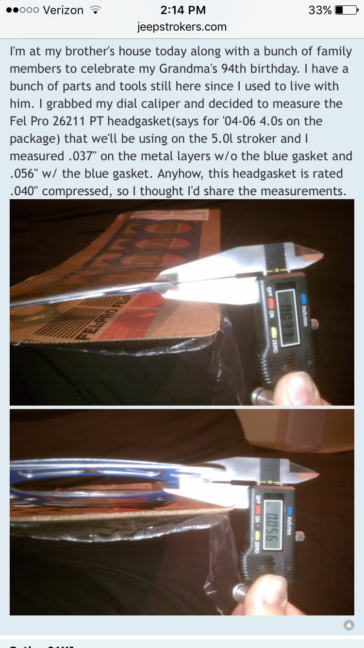

Which I am not even going to pretend that I understand. The only difference that jumps out at me, besides how they look in the pictures (who knows how accurate those are) is that FPG 26211PT Cylinder Head Gasket Combustion Chamber Opening 3.990" and the other two are 4.000"

This gasket is at least .010" thinner than the other Fel-Pros, so will give you better compression and quench.
