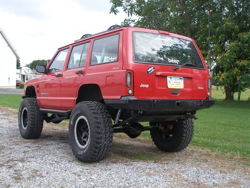

Does anyone else have any feedback on this mod? I'm thinking about doing it to clear my 37's on my 2 door with an interior D & C cage. I hit this area alot when wheeling on the Con/Fordyce and think that cutting it would be a good idea if I can do it clean and not cut anything structural.
Troy
Big red, First off your red rig looks freaking sweet. I also have a 2dr on 35's running a full cage. I cut my rear quarter panels and also cut out my rear wheel wells. When designing the cage I incorporated a 3/8 plate reinforcement for the loss of structural support. Anyway, with the quarter panels a sawzall with new blades would work, but i used a jigsaw and it makes it look 10 times better. With all the extremely added support of a full cage none of these mods have made any difference in the flex of my body or anything structual, and I have zero rubbing, even at full flex. If you think it looks good and will help, do it. With a cage you have no worries what so ever. Good luck!

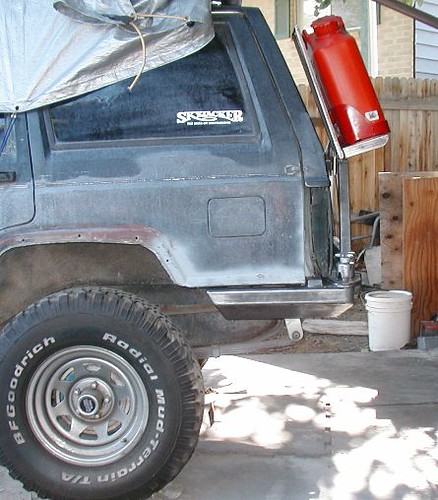

mine...

i would just like to say i really like this mod, but what is everyone doing for bumpers to cover the extra material behind the shackle but still take advantage of the clearance gains by angling the edges of the bumper up wards?
