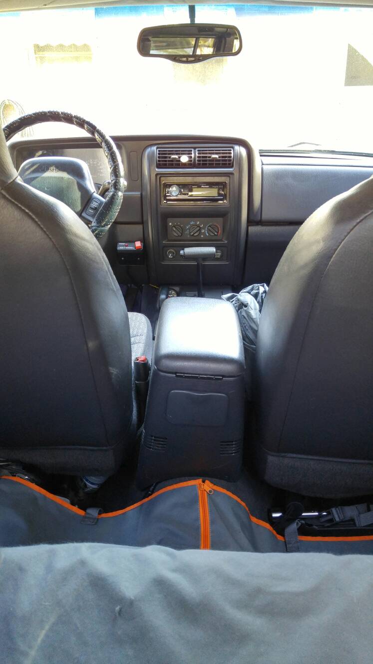

Same here. It is solid once set. I had to bend it and add a small nut as a spacer to level the console. Here is what it looked like before I leveled it.
