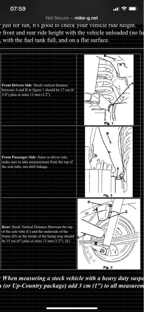

Well from a to b on the front drivers. I have 13.5” and from c to d in the rear I have 15 3/4”. Don’t have bump stops so not sure exactly what calculated height I’m sitting at in the rear. But according to that I’m 6.5” in the front.
Measuring from floor to rocker panel, front and rear. There is a 2inch difference. Idk maybe I’m getting more from the shackles. And the RC 4.5” springs I had before we actually more. It’s possible I guess

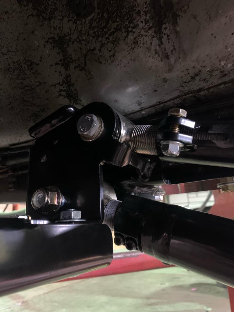

—Side note, IRO long arm upgrade kit fails to mention some extra clearancing you should do to get the maximum amount of articulation.
Mine, the upper control arm hit their bracket pretty early before allowing for very much droop. (emailed iro, they say ok to clearance the bracket no more than 1/4”) the uppers will also hit on the top side of the arm on the axle bracket. Easy clearancing, get all your money’s worth.
Cut that strap all the way off
Curious how much link seperation right there 4"?
Tempted to cut it all, but if I don’t need to then might as well leave as much as I can.
I’ll measure next time it’s up in the air. Eye to eye? Curious why you’re curious, they shouldn’t ever come in contact with each other.
Bolt center to bolt center.
Just curious. Seperation changes characteristics alot. Some long arm kits have little to Seperation on the frame side and axle side is factory 9".
I think I was only able to get 5" Seperation at the frame side. Ive thought about going through the floor and getting 7"
Just curious is all.

arent they a little bit too close together or this is just my imagination?
