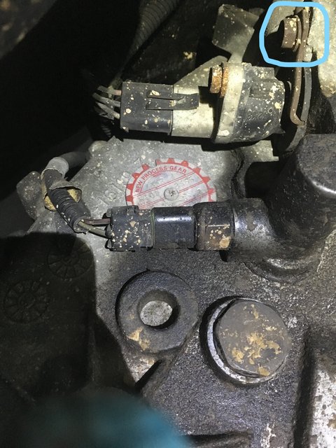

I've managed to damage the head of the bolt that fixes the horseshoe shaped clamp to the speedo drive module on the transfer case (NP 242).
I cannot find the part number or size of bolt so can anyone help please?
I've got a photo with the bolt circled but dont know if it'll upload as this is my first attempt at posting a phot - fingers crossed! :helpme:
Final Q (if photo loads) - what is the sensor below the speedo input (2 wires)?
Cheers!
I happen to have a 242 sitting in the garage. A 5/16-18 threads in there nicely. The hole depth on mine measured 11/16ths, so a 3/4 is going to be very close to bottoming out without a washer under the head.

My parts guide says it's 0180 077 (Screw, Speed Sensor). Search on the part number I get:
Part Description Bolt Hex Head 5/16x18x3/4
https://www.moparpartsgiant.com/parts/mopar-bolt-hex-head~180077.html?vin=&make=Jeep&model=Cherokee&year=1996&submodel=&extra1=&extra2=&filter=(E=ERH;T=DDQ;M=4%20Door%20Sport%20Utility%204WD)
The sensor below is likely the transfer case indicator

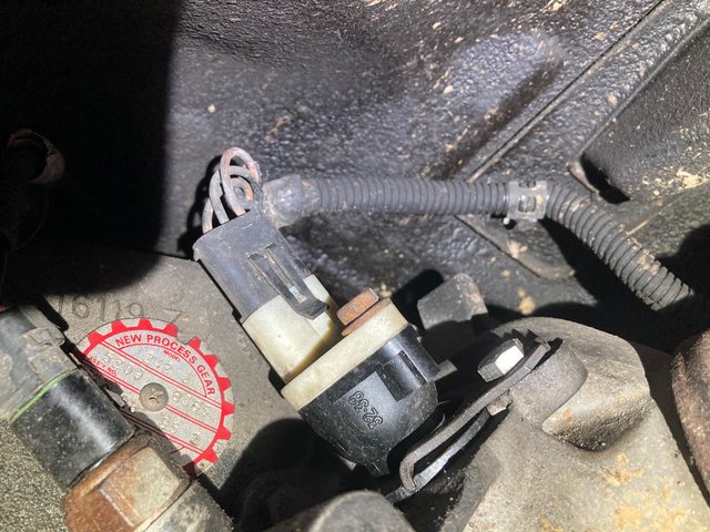

Spot on - here's a photo of new bolt in situ.
And yes, sensor below VSS is 4WD sensor (aka 'Mode' switch)
