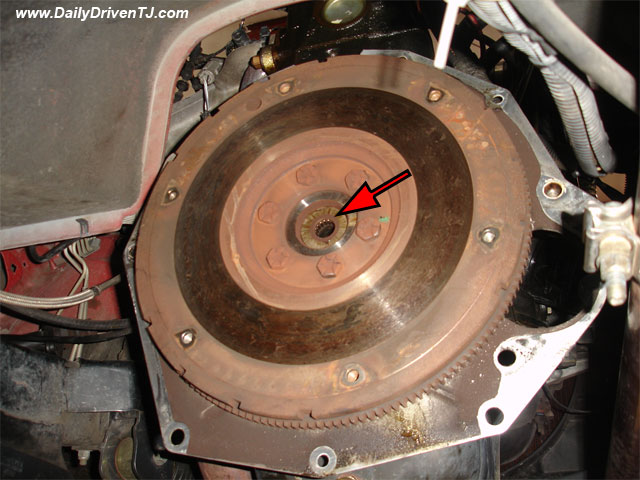

My 93 donor engine came from an auto-trans XJ. My 99 recipient XJ has a manual-trans. When the donor and recipient do not have the same tranny, then you need to get a new pilot bearing to match the recipient transmission. No biggie, you should probably get a new pilot bearing while you're in there anyway. Just buy a pilot bearing that was made for your 98. I didn't have the proper tool to pull the old pilot bearing, so I just used an old trick to get it out.. which is to pack the air-pocket behind the pilot bearing with grease and then find a rod that is the same diameter as the inside of the pilot bearing. Put the rod in the pilot bearing and whack the end of it with a hammer such that the grease pushes the pilot bearing out from behind.

pilot bearing (shown with flywheel on):
