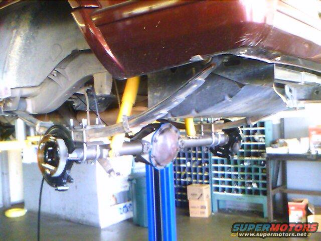

I finally got around to having the D44 I bought a while back installed - no driveway plus the new job eating up my time meant handing it over to have the work done, so stuff sat for longer than planned while I got the cash together for the work. Had 4.10 gears, ECTEDs at both ends, and a Teraflex rear disc conversion done at the same time; it's all shaping up pretty nicely. Sorry for the crappy cameraphone pictures, but they mostly get the idea across:
I'm pretty sure this axle wasn't an option in 2000. Note the relocated shock mounts :)

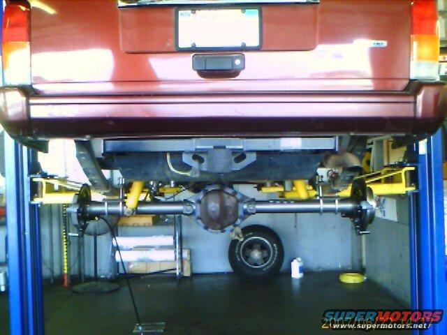

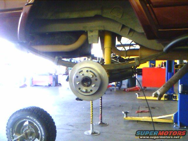

View of the rear discs from the passenger side.
Here's the driver's side - you can see how the handbrake does its thing.

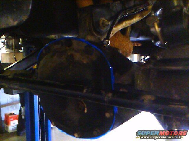

Mmmm, ECTED goodness.

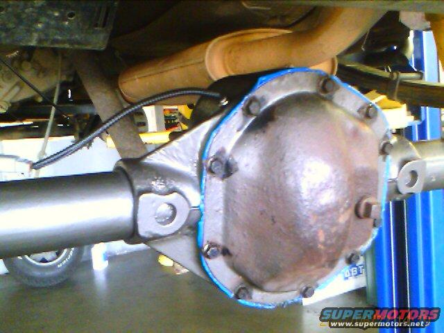

The D30's ECTED. The camera may suck, but I like the electroluminescent effect it gave the RTV. Now I just need the subwoofer to go with it.

Can you get a picture of the e-brake connection please(i know about the shoes and the rotor acting as a drum, where the cable connects) , I'm really tired of the junk shoes n drums.
Sure. It's still in the shop but I expect to have it back somewhere between Monday and Wednesday, so I'll get a picture after it's back.
Out of curiosity - do you just want to see how the cable routes over the axle to the brake itself, or something else? I think that's what you're looking for, but just want to double-check.
RyanM said:
Yeah where the end of the Stock Ebrake line fits into the backplate of the discs.
This may take a little longer to get than anticipated. Got the XJ back yesterday, crawled under it last night to change out the speedo drive gear, and noticed that the driver's side rear wheel had a nice puddle of brake fluid in it. Not sure if it was left over from them bleeding it or not (going to hit it with brake cleaner later in hopes of getting a clean read; fluid level looked OK), but I'm going with something being screwed with that caliper. Anyway, it's likely going back in to have that sorted out today or tomorrow. Grr.
