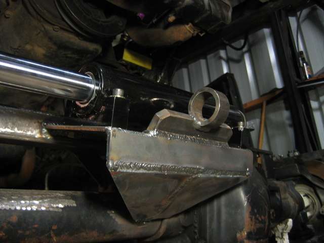

That welder will be fine, and I agree with go1lum and use 100% co2 for a hotter weld, but I would use .030 wire. My buddy's Hobart 140 does great. Prep is real important, but you won't need to preheat. Just make sure you are getting enough heat in there. The .030 wire will help that. I used it to weld up my 1/4 inch wall control arms for my XJ.
Here's the 140:
