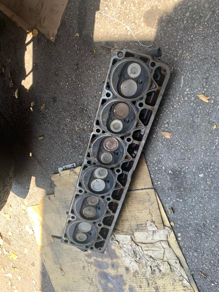

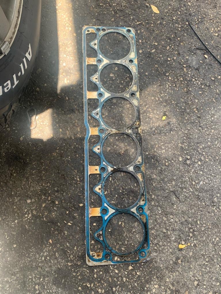

Thank you all for the input. We went ahead and disassembled the head, as we had done all the previous tests we could think of, and this is what we saw. My mechanic says this is definitely the cause of the overheating, but just wanted to run it by here to se if you have any input regarding it. Also, he suggested taking the head to be machined, to make sure it is well. However, I do have an 0331 head, and i'm afraid of it not lasting as long as it should and having to repeat this whole process again.
Also, the engine block has a sticker from Jasper stating that the engine was rebuild (or changed, haven't looked into it), and another sticker was on the fan shroud stating this was done when the car had 101,000 miles (currently at 130,000) Not sure if this is relevant to the situation just putting it out there.
Any input is recommended as I don't have too much prior experience when it comes to pulling an engine apart.

Most likely the engine was changed for the same reason, and another crack is almost inevitable. Exact same scenario happened to me with an 01.
I'd look for the "TUPY' letters on the casting. It should be on the inside area of the VC near the 0331 casting number. If it doesn't, I'd get a 'TUPY' head and have it reconditioned. I think '02-'06 are TUPYs. I might call Jasper, but I don't know their warranty. I would guess time and second owner are a 'no. Also, I'd get new head bolts.
