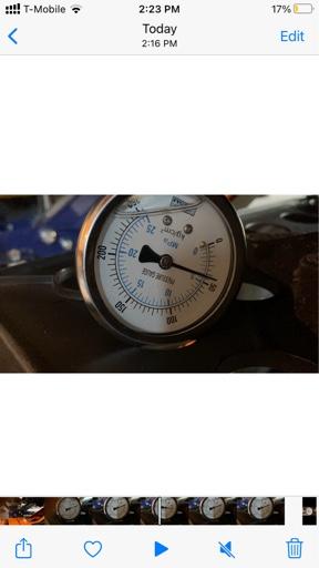

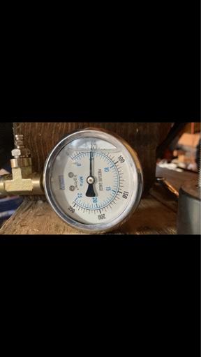

I ordered a brake pressure gauge from Amazon and I’ll try to measure the psi at all four corners tomorrow to see if it was a giant coincidence of two failing or if something happened and now I have excessive pressure in one place.
The MC isn't capable of excessive pressure, you might find a line with decreased pressure because of restrictions, but......
So after a swap to stainless braided, zj proportioning valve guts installed, and a full system bleed, I measured 50 kg/cm^2 or 711psi on the driver side and 43kg/cm^2 or 600psi passenger side. No reason for the new lines to break like the last two, but the pressure seams pretty low to me.
