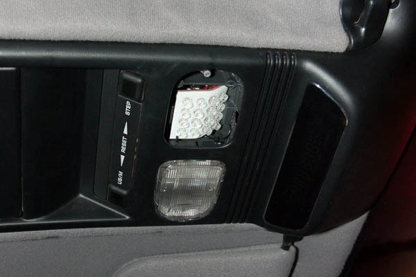

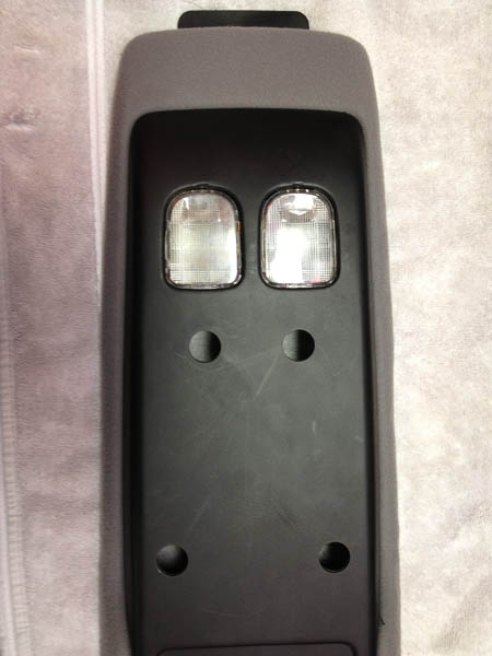

First up: replace the bulbs in the existing dome and courtesy (foot well) lights with LEDs. I chose these flexible LED light bulb replacements from Oznium.com:
The flexibility allowed them to squeeze into position in the overhead console with very little effort. I didn't even use the adhesive backing. And the multiple adaptors that come with each one ensure that you can use them to replace virtually any automotive light bulb (space permitting, of course).

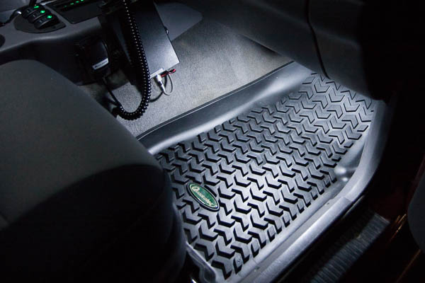

In the footwells, the wire length allowed the LEDs to be more centered under the dash, and the adhesive backing made it a simple peel and stick installation.

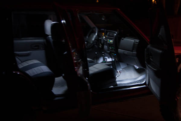

The results were mixed. The footwells were very well illuminated, but the rest of the interior showed little improvement -- yes, the quality/color of the light seemed better, but it wasn't significantly brighter than with the factory incandescent bulbs.

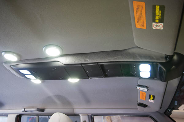

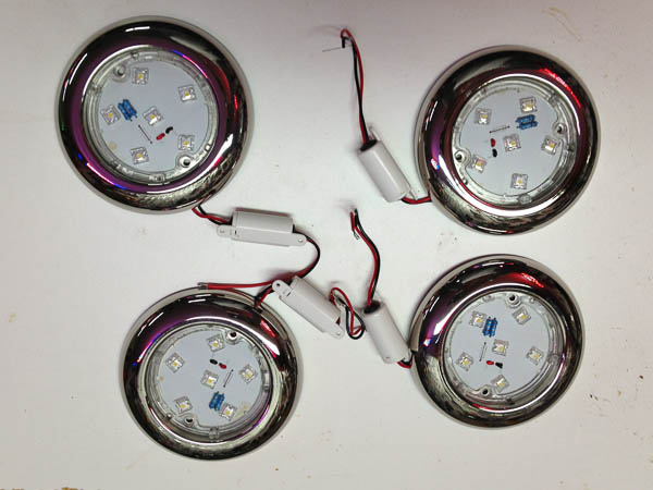

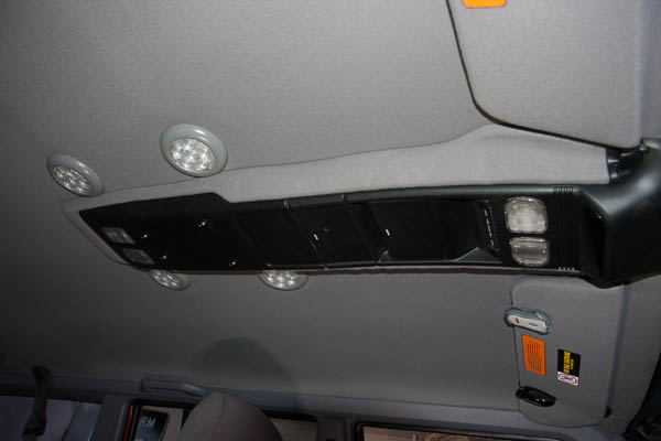

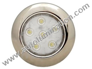

Clearly, more lights were needed. Next up was the addition of these surface-mount LED fixtures from autoillumination.com:
They're polished stainless steel and use 5 surface-mount LEDs. They draw only 220ma@12V and produce 240 lumens of output -- now we're talking!

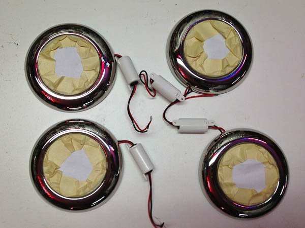

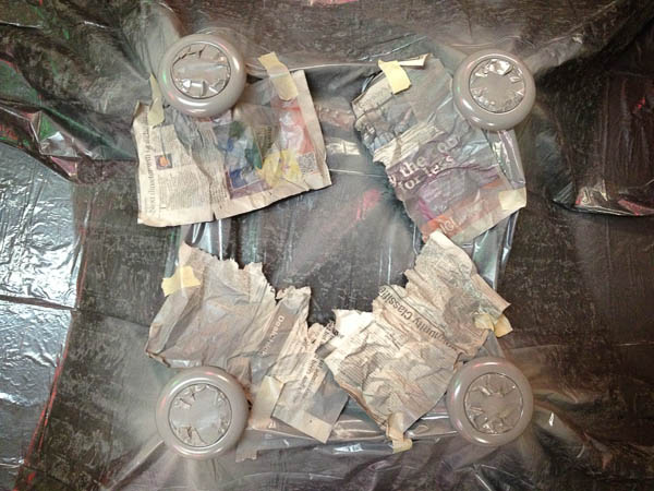

Here they are without the lenses, being prepped for painting:
Lenses taped off and reinstalled:
In the uber-sophisticated paint booth (a 55-gallon drum liner cut up and draped over 4 spay cans on the garage floor):

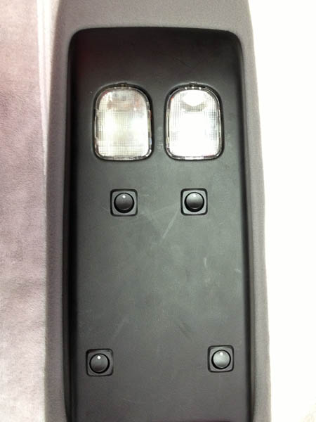

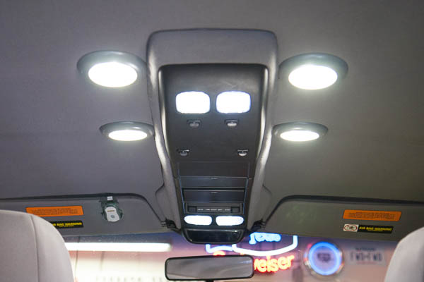

While the paint was drying, four switches were added to the overhead console -- each new light can be individually switched off in the event that some whiney passengers decide it's TOO bright:

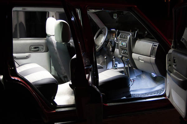

Installed:
They work!
MUCH better -- the photos simply don't do it justice. The difference is huge; now we can see EVERYTHING in there.

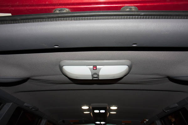

Next up: the cargo area. Inspired by this JP Magazine article, the useless old factory cargo-area dome light was replaced with one of these dual-bulb fixtures from Camping World. After a quick trip through the uber-sophisticated paint booth, an additional button was installed. This was done so the light can be turned on even with the doors closed, such as when camping in the back of the Jeep (I've never actually done this, and probably never will. But it was an easy feature to add, and the switch was just lying around in a drawer. So so I figured, "why not?").

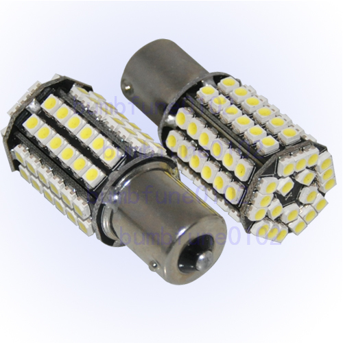

The included incandescent bulbs were replaced with these corn-cob LEDs (sourced from ebay):
I can see clearly now the bulbs are gone!

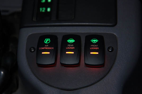

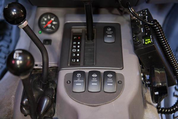

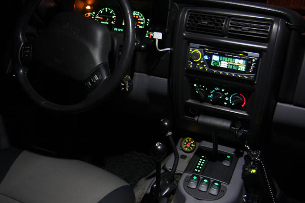

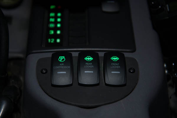

Next up: Replace the old ARB switches and their goofy/backwards illumination. Using new actuators from the good folks over at otrattw.com and LED versions of the Carling Contura II rocker switches, the look is much more OEM-like:
And the illumination is now correct -- the graphic (used to identify the switch in the dark) is illuminated with the dash lights, and the status indicator is illuminated when the switch is turned on:
The stock green LEDs in the Carling switches were replaced with turquoise LEDs and a dimmer circuit was added to better match the XJ's dash illumination color & brightness. My wife just rolled her eyes and walked back in the house, shaking her head slowly while muttering something about having married a geek. Bless her heart.

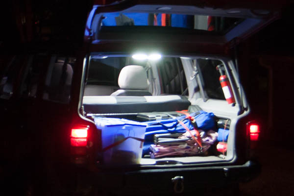

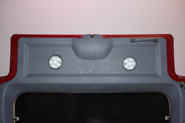

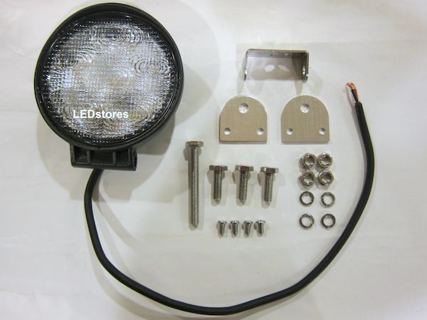

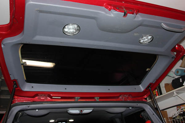

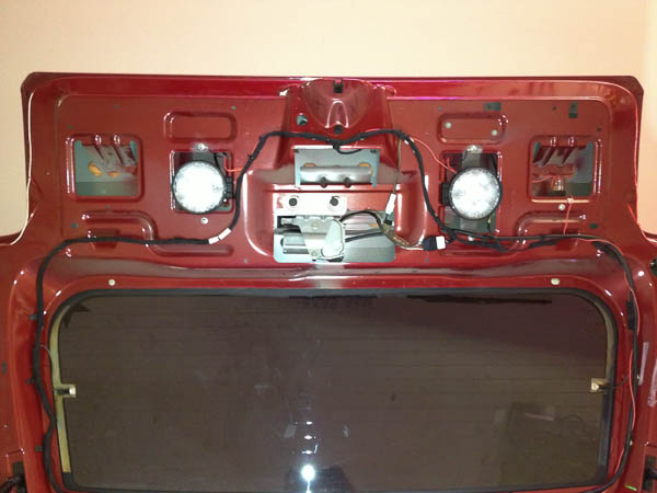

Next up: Loading lights. Inspired by http://www.naxja.org/forum/showthread.php?t=916188&highlight=lift-gate+lights]this thread, I decided we need loading lights. Just in case. These LED floods available from several sources including ebay, seemed a perfect choice (18W, 1,350 lumens EACH). Yeah, that ought to do it:
Using the tapped holes on the back of the lights and a piece of 1/8 x 1-1/4 flat stock I found over in the corner of the garage, the lights were mounted in the lift-gate. No sheet metal was cut, just a few holes were drilled.
Two holes were cut in the trim panel with a 4.5" hole saw; they had to be slightly enlarged after that. Next, the switch was installed and the trim panel replaced:
The result:

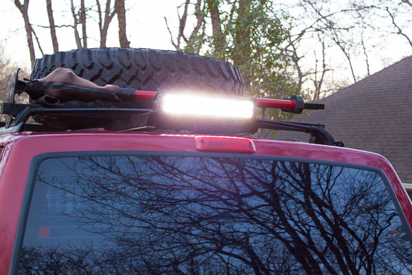

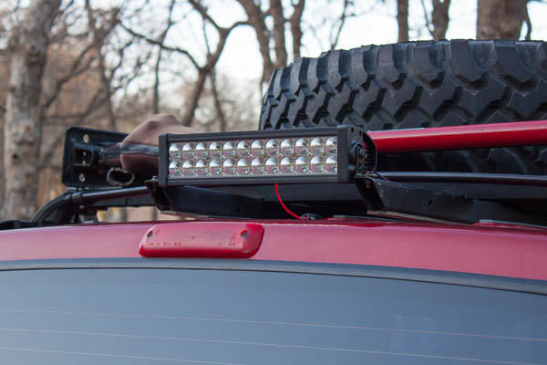

And finally, the obligatory reverse light. Between the tinted windows and the lame factory reverse lights on this thing, backing up in the dark was a crapshoot at best. It's a miracle I haven't killed someone. But, no more. I added one of these 72W, 5,400 lumen light bars (sourced from ebay):
Pics showing the install and the actual light output coming soon.

No doubt -- the stock backup lights are useless. The light bar works very well, though. If I had it to do over again, I might consider using two smaller lights and angling them to the sides just a bit. Visibility looking straight back is fantastic, but if you're turning and backing in the dark, the visibility behind and to the sides could be better. Nonetheless, I'm pretty pleased with the results. The improvement is just huge. I'll try to get some pictures posted later.

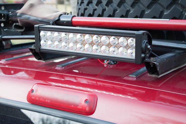

As promised, pics of the reverse light bar:

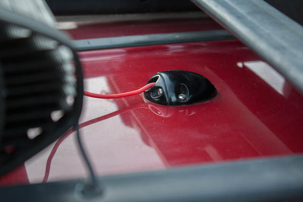

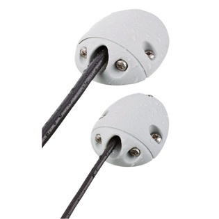

After much consideration, I decided to route the power wire directly through the roof (rather than out the lift-gate opening) using a waterproof cable feed-through like this one from New Age Marine:

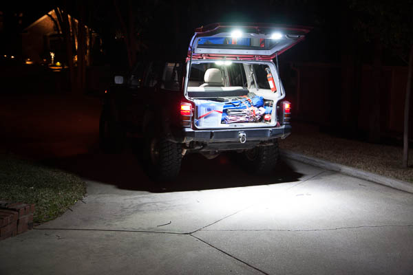

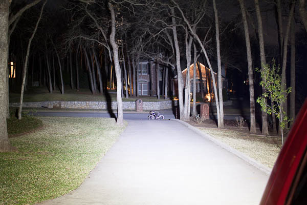

Here are a few test shots after dark. I placed my daughter's bicycle at the end of the driveway, approximately 35 yards from the back of the Jeep. For the record, the exposure settings are identical for each of the two photos below (1.3 sec @ f/5.6, ISO 400, for you photogs out there).
With only the factory reverse lights, you can just barely see the reflectors on the bicycle:
With the light bar turned on... well, you can SEE!
I'm not sure the neighbors share my enthusiasm for the new reverse light. ;)
