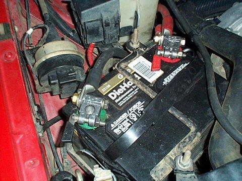

I run the lead military ones with quick disconnect clamps and recently partially melted one whilst winching. Never had an issue with them before though.
When I installed them:
from: http://jeepin.com/features/cables/
